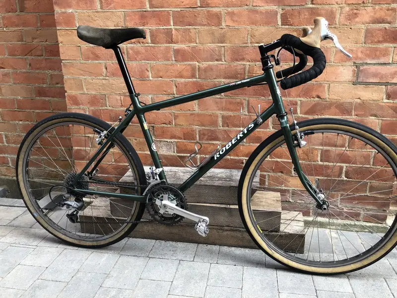

So… final build for now:
Frame and Fork : Roberts Roughstuff
Wheels : Mavic 231cd on M900
Bottom bracket: Royce
Cranks: Deore xt M730
Chainrings : Middleburn
9-sp cassette
Front mech : m900
Rear mech : m950
Shifter : Dura Ace 9-sp indexed
Stem : Salsa
Bars : WTB / Specialized RM2
Brakes : TRP RRL
Brakes : m900
Brake hanger : Paul
Seatpost : Paul
Saddle : Suede Turbo (may swap to spring brooks for the LoLs)
Tyres : Rene Herse/Compass 1.8’s
167E8A71-4033-47E1-9DF2-F51E4F7919A2.webp 090C31D2-DEF9-4CAA-948E-3A2E3F9EBA14.webp 310242D3-F1D1-44AC-91C5-9EC1F7165111.webp

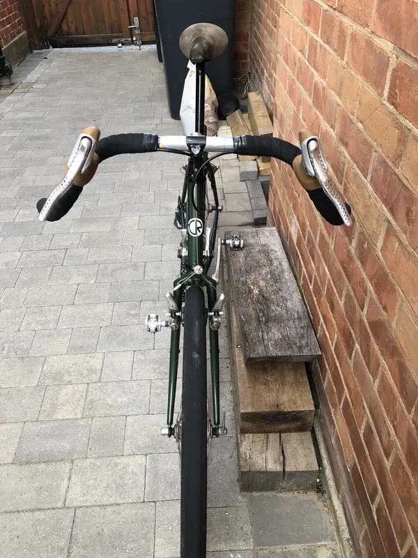

Good shakedown ride last night, all worked ok, I think the stem could be 20mm longer, and so give a bit more reach/rise, but I can ride the drops as it stands. Like riding a bmx, feels small after 700c and larger frames. Seems really flexible, I’ll fit some racks and use this to take the kids out, maybe even with a followme trailer.
Taken a few years, but glad to have this together.
Cheers for everyone’s input.

Hey, what size is the BB for the Roughstuff? Iirc it's a screw in like a UN 55 but I can't remember the width and my bike's remote for a few weeks so I can't measure.

I missed the questions here. Thanks for the comments and appreciation. I’ve not really ridden this enough though.
The bb shell is just a simple 68mm British thread.
68mm British threaded. I’d say that’s probably correct for all Roberts. Custom though so you might find something odd!
