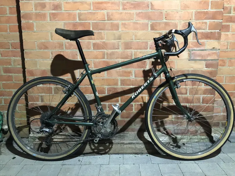

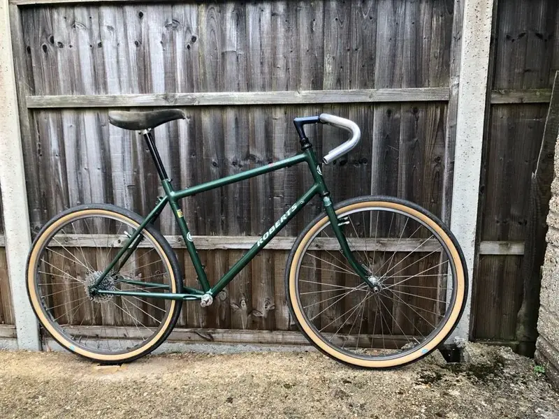

Just a few photos of a revised mock-up...
Will take some measurements and try out the position later... Saturday shopping trip calls :facepalm:

Well, a year later and I might get to finish this! Have had other projects, including a garage rebuild and baby (in that order) since my last post on this thread.
Have sourced a 80mm Salsa stem which fits well with the skinny tubes, using a 3T morphe bar for now which gives a flatter transition into the hoods. Feels reasonably comfortable for reach, height etc. Could have another 10-20mm reach but some of this would come with a change of bar should I wish.
Swapped the bb (Royce), have some xt 730 cranks, will probably use these xtr 900 wheels and Compass tyres. Will go with Canti brakes, m900 probably. Shitfers will be either the Paul thumbies mounts on the bar or barends (both use the same actual shifter) - also have some Kelley ones which would use a downtube shifter adjacent to the brake, but on another bike I’ve not been convinced by these.
Need to tap through all the bottle and guard/rack mounts before I cable up.
Cheers!
Edit : seat needed nose up a bit, raising 1cm and sliding back (as it’s an in-line post) which has added 10mm to the reach. So not far off where I should be comfortable.

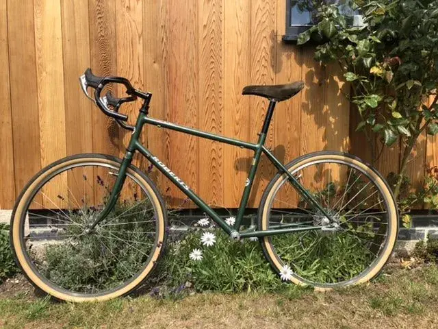

Another couple of years pass (!) and I wanted to try this out properly for a few reasons.
After all that delay, it only took a couple of evenings in the garage and the parts are swapped from my Cumbria (which is being sold).

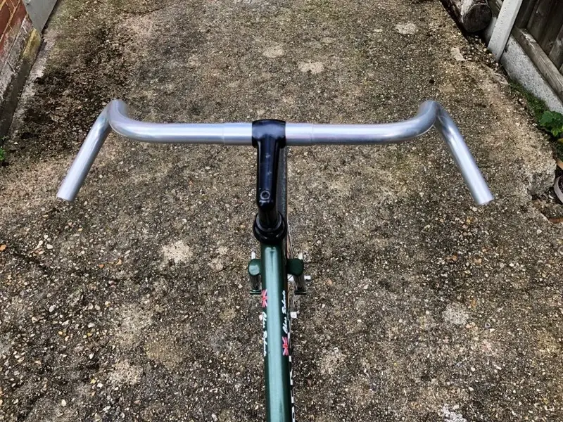

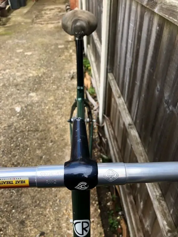

Looks an odd shape, I’d prefer a little larger but the main contact points work… could have more rise and length in the stem. Will have a quick spin tomorrow. 1BA76AE6-58EE-429A-A783-04522B24256D.jpeg
I would get rid of that road bar in seconds and install a dirt drop but h bars are personal choice/ comfort etc... I have used dirt drop bars and love them. Ergo road bars otoh... but i digress. Fit is perfect w/ no drop from saddle to top of the bars. That´s a very very cool bike you have there. Timeless!
I agree with the above, so many drop bar mtb’s look like they’ve been thrown together - this one looks perfect. Maybe it’s the sloping top tube? At any rate - it’s gorgeous, love the colour, component choice, and the fact you went for downtube shifters. A long while in the making perhaps, but a well considered and executed build. Good job. 👍

I do have a dirt drop here, so might try that out too. Got the whole 25.4mm vs 26.0 going on so would need an alternative stem, plus would probably move to bar-end shifters in that event.
Agree that the seat/bar heights look reasonable.

I think it´s the long steering tube of the frame which makes it look coherent? Anyway, this is one understatedly sexy looking bike!

There are shims around to take care of the diff. bar widths. Soma sells them. Dirt drops are wide and shallow; they make your upper body work better on singletrack giving more control when mountain biking. Road bars are made for steep angled road bikes where your legs and hips do all the work on smooth tarmac. I am sure a lot of you will disagree; that´s my experience.
