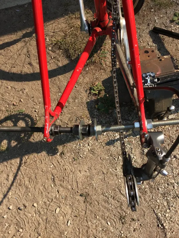

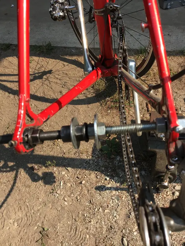

He might be ok with only a 7 speed though. I would avoid having to spread the rear drops. Here is one where I spread the drops for a 9 speed. Some of the middle gears are a sluggish change and the adjustment is tricky. IMG_0709.webp
did you realign the derailleur hanger?
No, I have a homemade tool for that. Thanks, I’ll check it. I didn’t think of that. I did have a bike shop check my drop realignment from my homemade tool with a real tool and that was spot on. It works good enough, but better wold be nice.
not much to check, it's a bar with a pin through it, mines home made from a 1" box section and a wheel axle.
