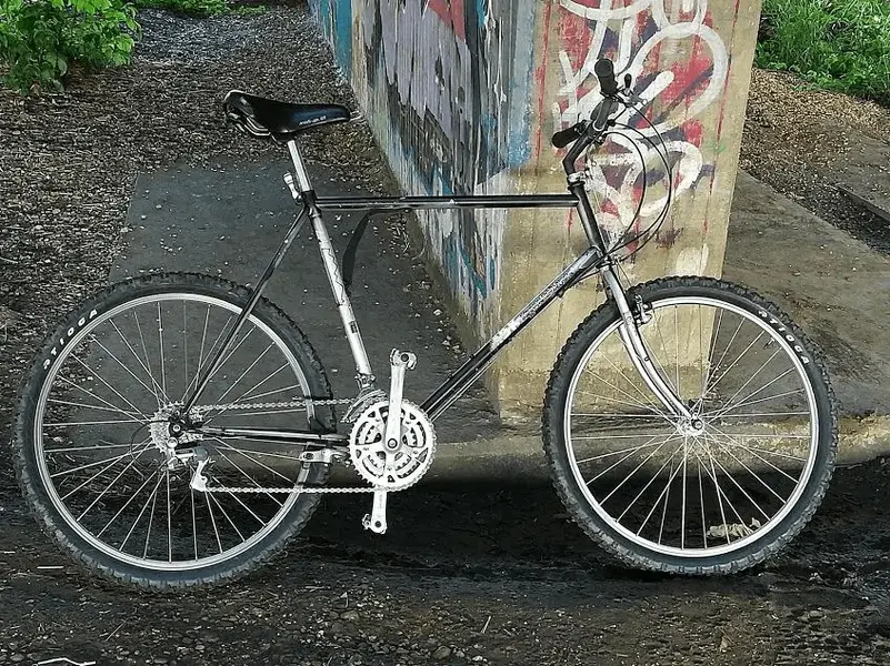

Had a Dura ace 7400 it was already on the bike when I bought it at a police auction
It was a Trek can't quite remember the exact model

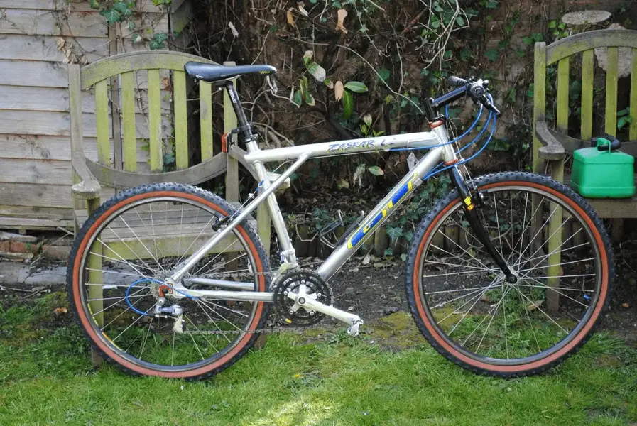

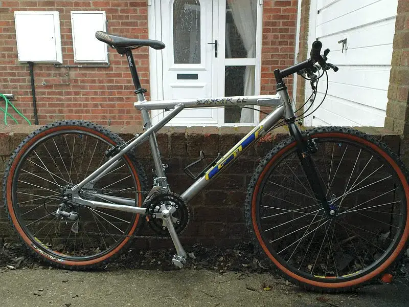

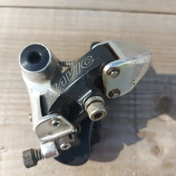

Mavic 840 with 12-28 Shimano HG70

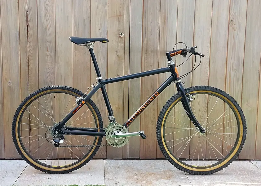

I Run it with Suntour XC pro Microdrive
Built a 2nd recently with the same format but issues with spring tension needs some tweaking.
Original #1 Aluminium "O" (Gen 2)with Mavic 840

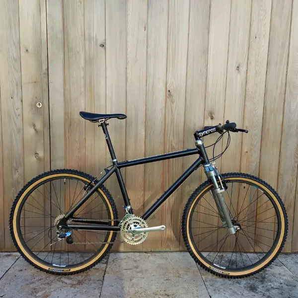

#2 Aluminium 'O' (Gen 1) with Mavic 840
MAVIC 840 Road rear mech

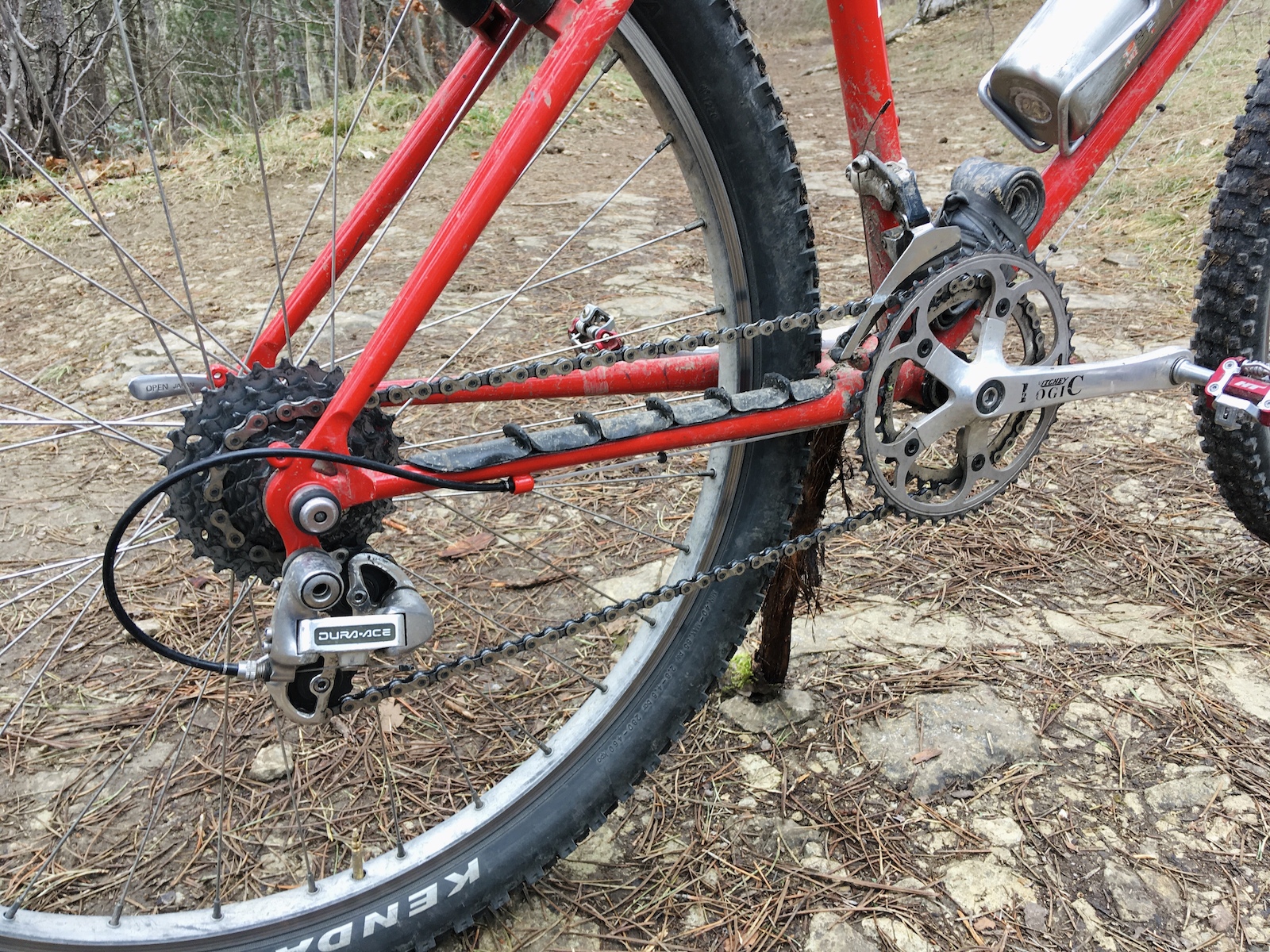

I've got a Dura Ace rear derailleur on my Catalyst, combined with a 12-28 cassette and 34t/46t chainrings.
