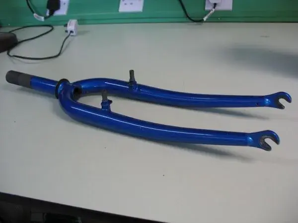

These forks came off a Merlin (Lancashire mail order place) Team Prestige SE bike from the mid 90's. I was planning on fitting them to another frame as the original was stolen some years ago. Unfortuantely, the steerer is to short, so that put a stop to that idea. So, I need another set, but would like something of similar quality to these, but I need to know whether they are generic forks or something a bit more interesting.
They weigh 850 grams with a 155mm threaded steerer. Hopefully, I've managed to attach some pictures below....

They are cheap, mass produced, Asian made forks, weight is not terrible, but not great either, plenty of better forks available cheaply. Look for something Spinner branded, or for a few quid more, a Marin Rockstar or even a Kona project 2.
As the weight is not to shabby and they dont have rack eyes, I would suggest they are at least a 'quality' fork.
A plain gauge tange MTB / Spinner fork is + 100g on what you have there :wink:

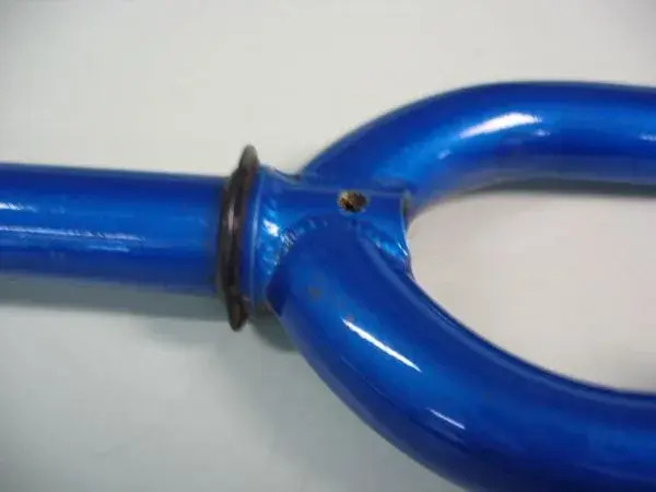

I actually suspect spinner, cleaning the paint off the outer face of the dropout and / or the front of the steerer should confirm.
WD :D
Thanks chaps. There's no markings on the drop outs at all, and the markings on the steering are quite faint. I can make out:
AKISb (i think it's a K)
996 07
F CR-MO

they look like a nice fork
cheap asian made right enough , but nice
spinner x's are great btw , rigid and plush
