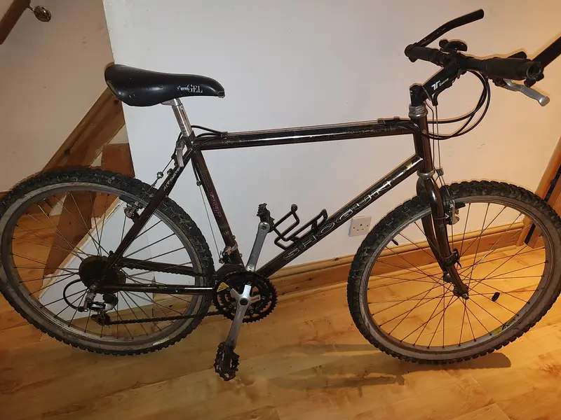

Picked up this rather ratty but original Prairie Breaker from 1991 at the weekend.

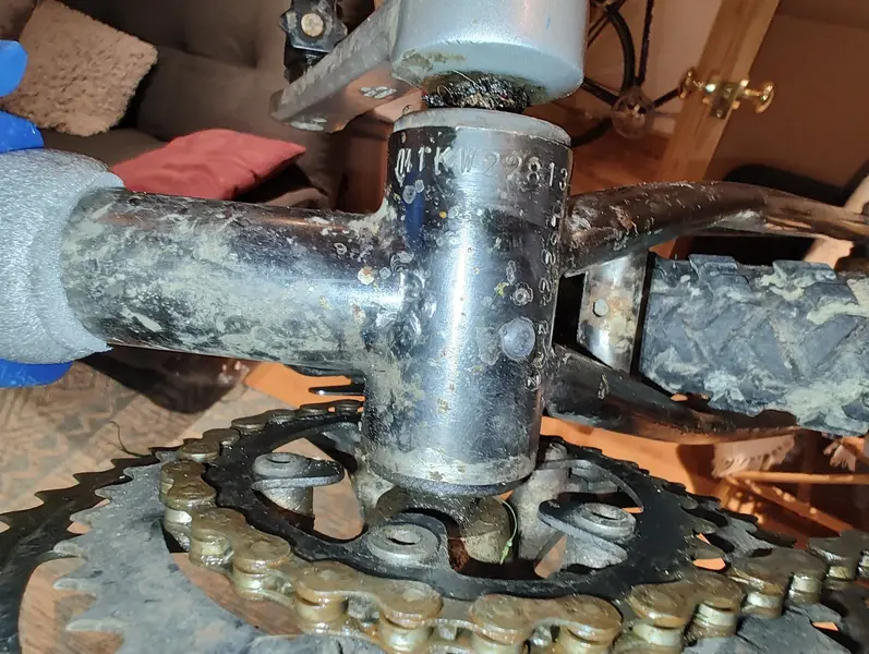

...stripped away some of the tat and removed the worn out components seat post was free but quill stem fused to the steerer and bottom bracket beyond the pale...
.... lengthy battle with this BB and a ton of penetrating oil and managed to get some movement on one side - then this pulled out

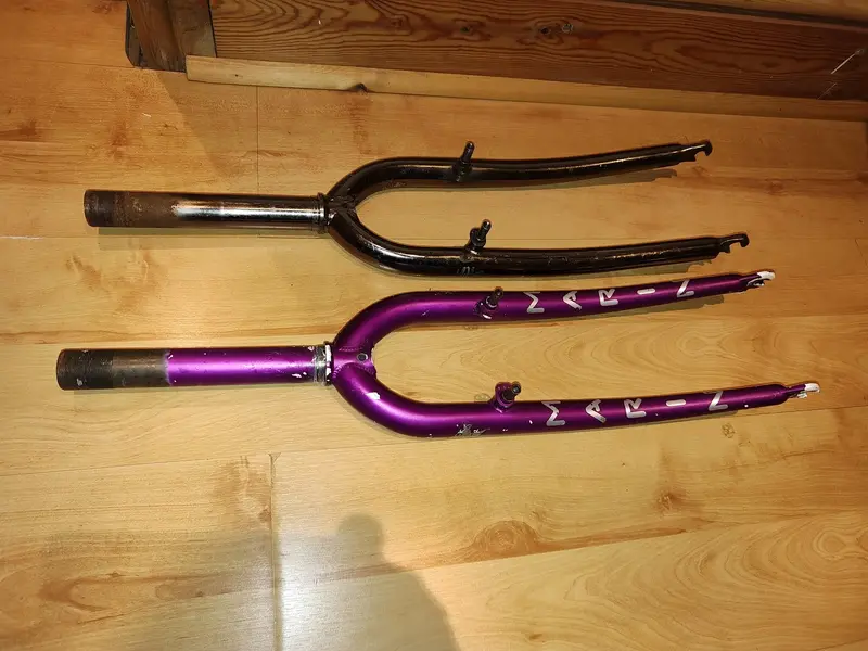

The steerer was also a big challenge - that Tioga stem was certainly very strong and survived the ordeal, although the (Spinner cr-mo) fork steerer has heavily corroded threads so I sourced another very similar fork
interestingly these 2 forks are within 6 grams of each other in weight and nearly identical in other respects the original is marked Spinner TO and the substitute is Marin Rock Star - only the dropouts seem to differ.

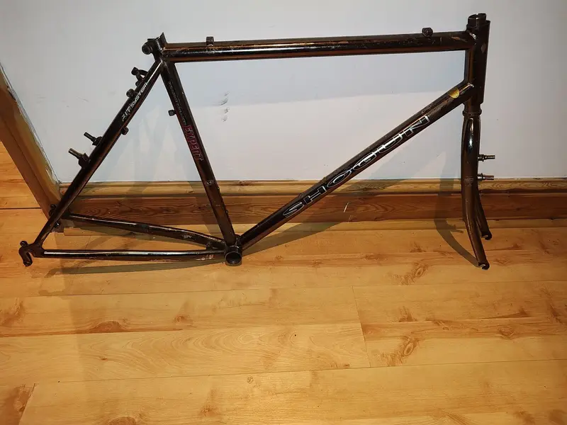

so frame and forks prepared for next stage dipping, sandblasting and then powder coating
I am unsure on colour scheme but will choose something radically different to the rather drab original and will attempt to find some decals or get custom ones cut once the frame and forks are done - next update circa mid May
