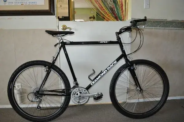

Have you got a picture of the Apex? :)
sure :) I got the frame with crankset, saddle and seatpost, everything else is from the parts bin
