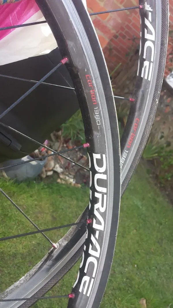

Yesterday's dump find, a pair of Dura-Ace climbing wheels for a tenner. Weighing in at approximately 1300g the pair i may be able to get the Raw Ribble weight down to near 7.5kg with these bad boyz. 20210412_125001.jpg 20210412_125020.webp

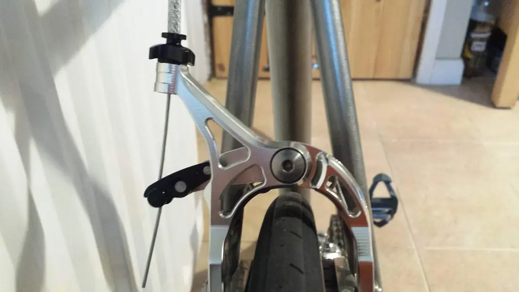

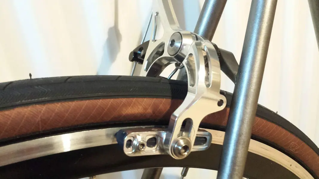

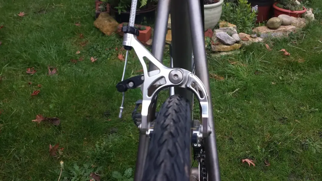

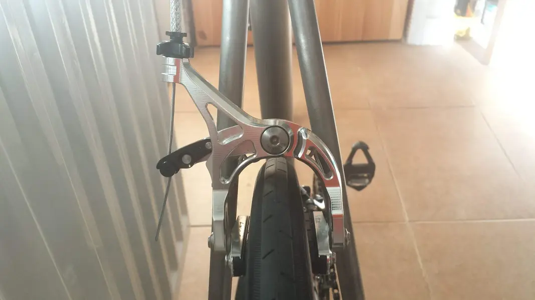

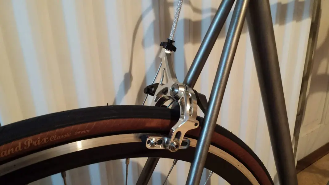

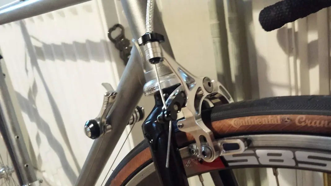

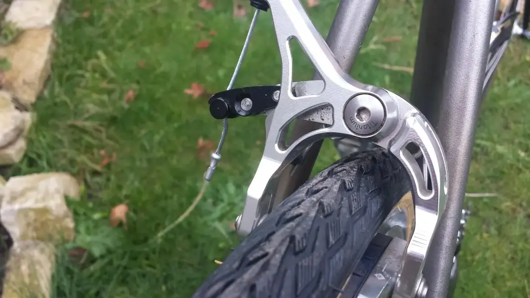

Had a look at the Dura Ace 7700 dual pivot brake calipers but quite heavy at about 340g so decided to go for something lighter and modern but retaining that classic single pivot look. After a bit of searching on eBay a set of barely used Planet X Ultralight CNC were snapped up. The calipers have an ingenious lever cam that gives decent power and linear brake response while keeping the overall lever arm length and protrusion to a minimum. The cam divides the extra leverage evenly between the two calliper halves by being attached to the rear half at its fulcrum while simultaneously leveraging the forward half of the brake via a stainless steel roller... Nifty. The titanium hardware keeps the weight down to just 230g the pair with pads and Jagwire braided cables connect the TRP drilled levers...👍

What's the story with the cable ferrules? One of the photos show the rear ferrule missing then another photo it has been fitted while the front cable ferrule has dissappeared and then reappear later. The mind boggles. I'm having trouble keeping track of your brake ferrules. Is Tommy Cooper involved in this build?
