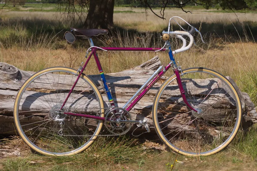

No bottles, no mudguards, 30mm tubulars and the open road.
The Cyclo spec says that FD will handle 20 tooth difference, but you have to position it vertically quite carefully to avoid the chain hitting the vertical cage limits. Bought a work stand to set it properly for 18 tooth difference and it works fine.
13-15-17-20-24-32 + 50/32 and all 12 gears work
(SunTour Cyclone mk1 GT + SunTour New Winner ultra 6, 120mm dropouts)
