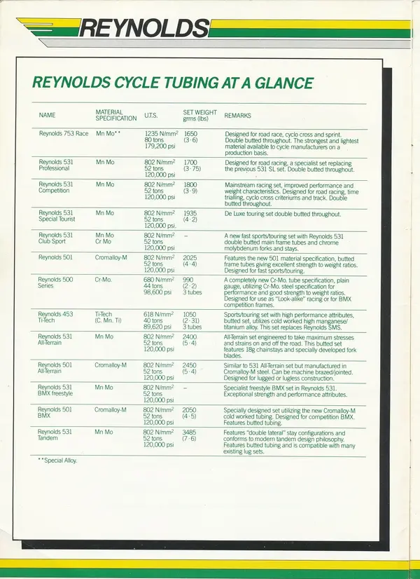

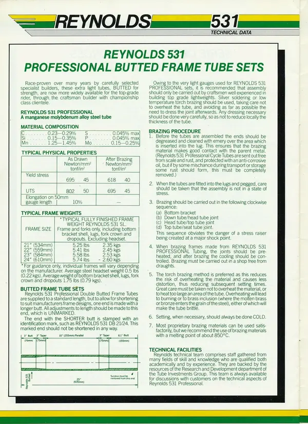

Here’s Reynolds cycle tubing from their 1985 catalogue. 531 Pro has superceded 531 SL.
This scan for 531 Pro sets out typical built frame and forks, ie including bottom bracket shell, all lugs, dropouts, etc. Helpfully suggests an average weight for these frame components on top of the tubeset, at about .79 kgs. I have seen 2 weights provided in different Reynolds documents for 531 Pro for the tubeset, 1.7kg and 1.9kg so seems editing inconsistency not just the preserve of the Guardian.
Many thanks that is spot on, and a very helpful reply cheers!
