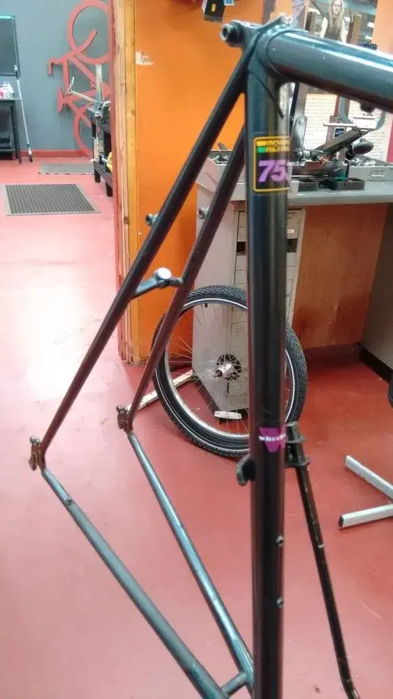

Thanks for the speedy reply! I've attached a couple of photos for you to see. There doesn't seem to be much information though.
Could you recommend any parts that might be compatible with it?

Looks a very nice frame. The question is what you mean by touring. For fast, light credit card and B&B touring it could be ideal. For loaded camping, forget it.
As MatBH5 says, 753 is a race-orientated frameset with ultra-thin tubes. These produce a wonderful bike to ride unladen. However they are on the light side for heavy loads - the frame will squirm and not be at all nice to ride. A light rack, mudguards and load of 5kg or so and you will have something brilliant.

Given that the frame has rear rack and mudguard mounts as well as pump pegs, I would say it has been designed for distance work.
It looks like it has over bottom bracket cable guides which might indicate late 1970's / early 1980's manufacture, this may mean you would be after a slightly narrower rear wheel hub compared to modern bikes, this is not a problem but it is worth being aware of before you start buying other parts.

Reynolds 753 can make an excellent touring/randonneur frame. It is not necessarily a race orientated tube.
Reynolds 753 came in many different tube gauges - it is not always the thin walled type - lots of later 753 is almost the same tube gauge as Reynolds 531, so it is not always too thin and not always too flexible. But because it is a used frame you are looking at, you may never know exactly what type of tube gauge you have. Knowing the seat tube outer diameter and seat pin size required for that frame will help to determine at least the seat tube gauge. Custom 753 frames can be spec'd with different toptube/downtube gauge dimensions etc
First thing you need to do is try and find out how old that frame is. I have a 1985 753 Randonneur with over bracket gear cables, so dating the frame by these features doesn't always work.
That frame has transfers from 1989+ Therefore, if those transfers are original, the rear OLN may well be 130mm
Most components are compatible with a 753 frame - they are just tubes that have the same diameters as other tubes in other ranges, you just need to check if the rear ends are set at 126 or 130mm - that will determine the type of hub and gearing you can use. The only way to check what tyre size you can use is fit a wheel and the size of tyre you want to use.
