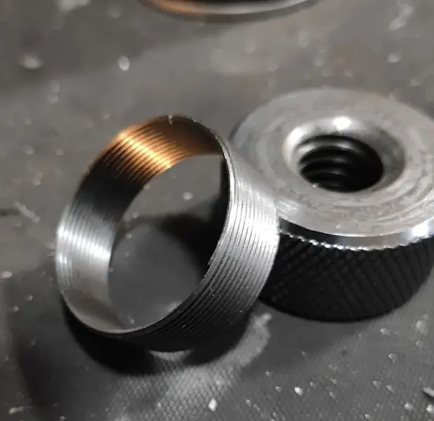

-Ream out and tap both sides to Italian thread then fit ELDI BB thread sleeves to create the BSA thread. (Pictured).

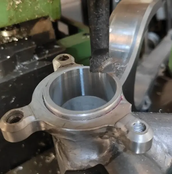

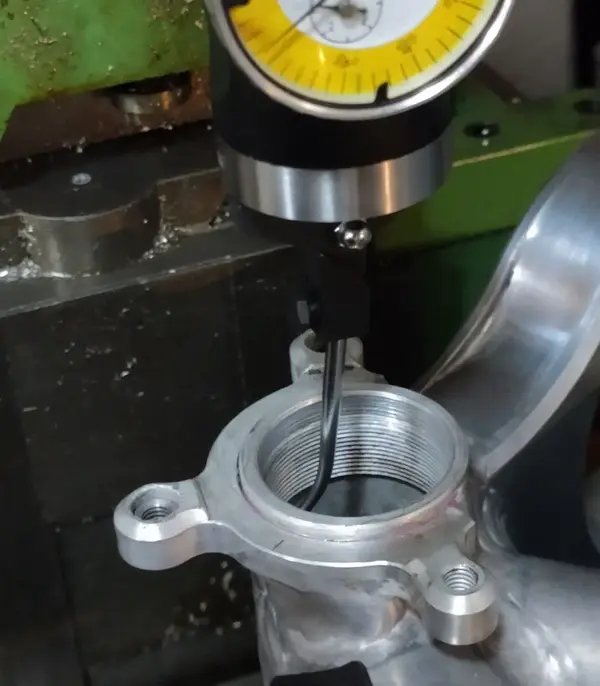

BB thread damaged on a customer's much-loved Nicolai.
Align the BB shell in 3 axes on the mill:
Ream out old threads:
Tap to Italian:
ELDI Insert:
Insert fitted (Loctite 638 Retainer):

BB thread damaged on a customer's much-loved Nicolai:
Tap to Italian:
ELDI Insert:
