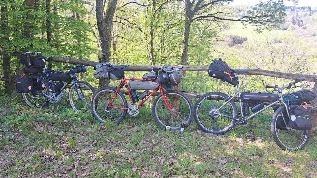

@KayOs you managed to pack so much staff on the front end without using a rack! It's pretty amazing. What's your trick? Keep strapping things on top of each other? What about swaying left and right if you have a lot of load and no rack?

It's hard to see on the pictures but I do have a small front rack mounted.
It's this one:
https://cube-magdeburg.de/rfr-gepaecktraeger-vorne-black.html
I like it because it mounts to the canti bosses and so acts a little bit like a brake booster and the high rear end of the rack also keeps the luggage away from the front brake cable.
In the front I just had some light stuff, the hammock, tarp and underquilt on the rack, sleeping bag and a set of cycling clothes in the front roll that is attached to the handlebar. Then I put two straps around the whole package and it didn't move at all. On the first day I also put 1,50l of red wine on top but that also wasn't a problem.
Most of the weight was in the frames main triangle.
In the small bag on the top tube I had some tools, smartphone and snacks, under the top tube some more tools like the 15mm hex and the air pump and all of the food. In the two bottles were 1,75l of water.
In the rear there were another 1,50l of water, Bluetooth speaker, power bank, cables, cooker and gas, toilet paper, towel, soap, tooth brush, a warm jacket, a windbreaker and a rain poncho.
The bike felt pretty well centered. We had quite some pushing and carrying to do along the way and it went really well.
I also like the centre of gravity a little higher on these kind of rides because the bike then feels a little more "nimble" on the trails. On long journeys on asphalt I like the stability of a lower centre of gravity.
The front also never felt wobbly but I think that's because of the sling shot stem. It felt rock solid.

We had all loading situations and I liked mine the most. Front heavy was a pain to push as the rear came up quite easily and rear heavy likes to wheelie on steep ascents with rocks and roots.
