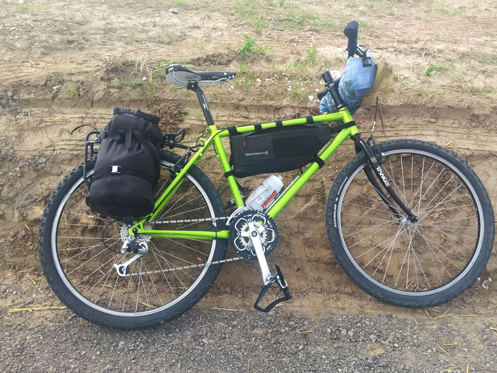

I have set up a touring bike for road and gravel, a 700c, flat bar, 2010 kona smoke.
Now i want to build a retro, off road, camping, touring, bike and bivi steed.
Its difficult because i have a 91 saracen sahara elite which is completely original (so it'd be a shame to change bits to suit and to wear out original parts and leave in the rain while camping.
Or i have an early 90s raleigh yukon i can build out of leftover parts but she doesnt have any rack mounts (considered getting some braised or welded on).
Or a pretty bad 94 marin palisades trail with kona forks. The marin is pretty rusty and has had the serial number grinded off at some point.
Either way, i am hoping to get something built up ready for spring.
Ill start by touring and camping on the isle of wight where im based as testers and once ive nailed the kit etc, ill start on mainland Britain.

Do you think its better to run old square tapered BBs and cranksets (which are harder to replace these days and take more tools to take on off out in the field) or change to modern, external BBs and either 3 speeds or singles cranks for more availability and less carrying tools?
The same with changing the quill stem to the slide on type by using a quill stem adapter so bars can be taken on and off without stripping them etc?
Cheers
I think it depends on how far and how remote are you going. Spares might be useful if you're somewhere remote like parts of Africa, South Amerca, etc., but for Europe, the US, etc. there will be plenty of places to buy them and get them fitted. Modern external BBs are pretty light, so you could carry a spare set of bearings, but unless you're covering a lot of distance, one should last the whole journey and square taper cartridge BBs like the Shimano UN55 last for ages, thousands of miles, maybe tens of thousands. If you're doing a really long trip, you could always fit a brand new BB, wheel bearings, headset, etc., before you set off.
