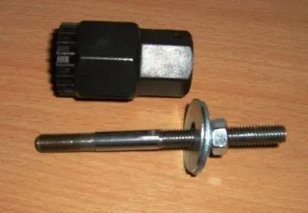

Made my own tool for holding the BB in place.
The thread in the BB axle is M8 x 1mm. The other end has a normal M8 thread for a normal nut. A couple of large penny washers hold the tool in place
