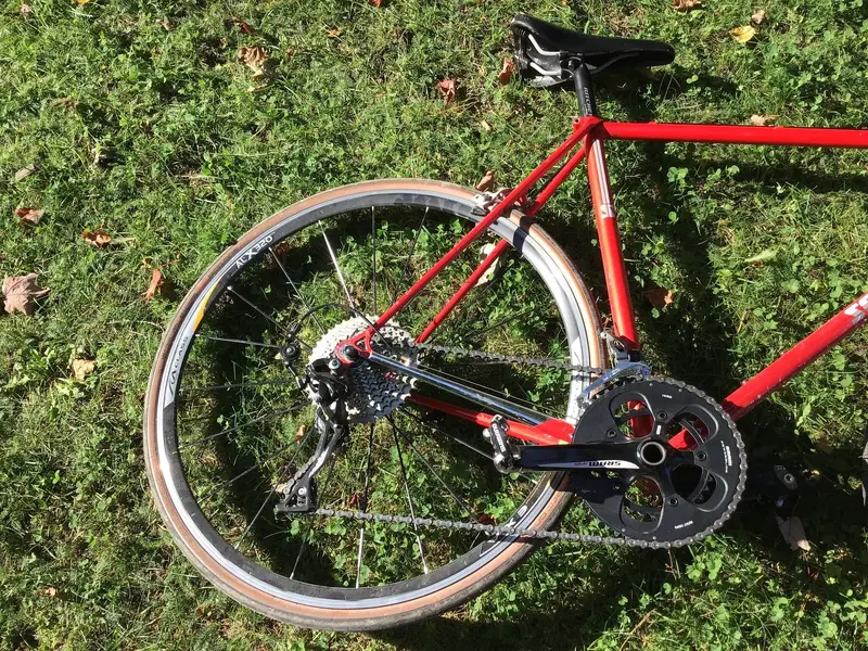

Planning to run a 9x1 with 11x32 or 11x34 cassette. Shimmy rear mech.

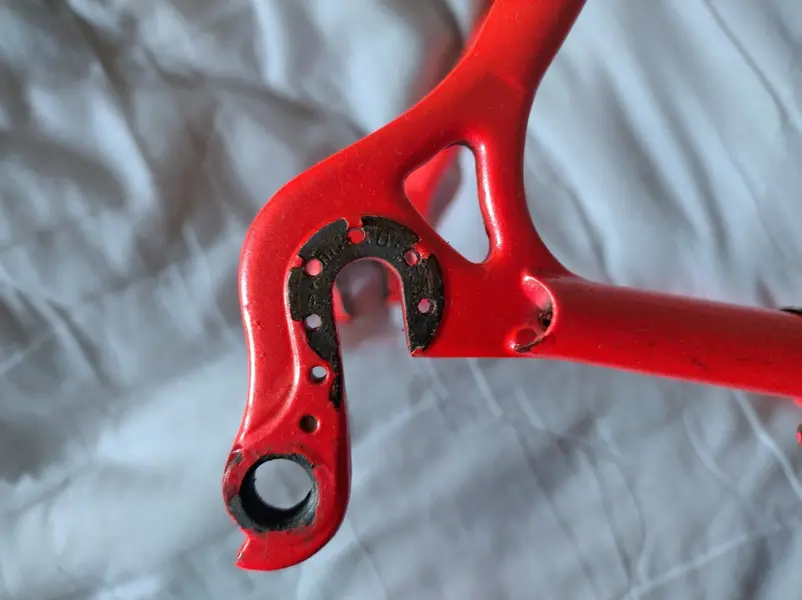

Thanks for the suggestions - I'll stick to my current hanger, but need to decide whether to drill an extra hole in the dropout (what can possibly go wrong?) or find another way to stick it on (gaffer tape?).
One bolt might be enough - the hanger's tang goes flush against the dropout and will act as an extra point of support.
Surely, this world has seen worse crimes done to dropouts...

Two by 50 x 34, 10 speed 11 x 42. Schwalbe Pro One 700C x 28mm. 1970s Columbus SL tubing. 170 mm cranks. Good for an old guy that’s 173 cm. Good on packed gravel, no good if there is any sand. image.jpg

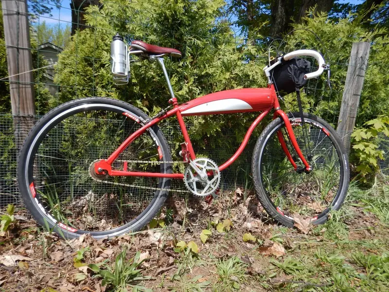

Here is my first gravel bike. 1953 Columbia frame, MAFAC canti front, old Phillips center pull rear, slingshot stem, gps mount, first generation Sagino cranks used as a single speed, lay back post and 40 mm tires. It rides extremely well. Picture is about 15 years old ane it now has a chrome fork. It needs a lot of tire pressure to avoid flats if there is any roots or rocks. I have ridden a lot of single track with it with 60 psi, no problem. Any less pressure and you get pinch flats. Shotgun shell handlebar plugs and brass pistol casing for valve caps. The front bag is for snacks and repair stuff. When it was first built I raced it in a 100km gravel race. I came in after the 100 mile rider were done and went home. The race director had run out of beer. B6A93C7E-F847-4805-9381-61D3A5575D2D.jpeg

@Nabeaquam Damn that is a nice bike!

- Retrofit the hanger;
