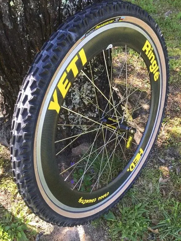

I'm intrigued to know now how to true these wheels too.
If they are similar to the example of Hed XC wheels seen below, I would doubt that using a conventional Spoke Key would be possible.
I am wondering what the screw thread end on these spokes look like, and presumably can be accessed somehow from the inside of the rim?
IIRC they use a non-standard nipple driver (hex?) that you need to take tyre/tube/rim tape off to access.
Cheers Matt, perhaps Darren could take a picture of the inside of the rim, which may help us with give some advice regarding truing these up.
