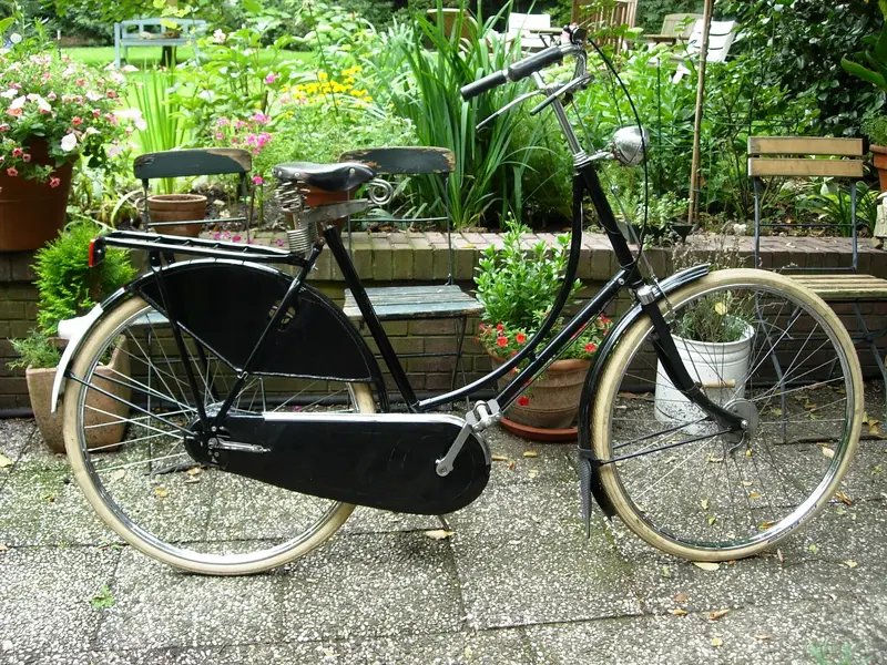

I did see a bloke on a Dutch Grannybike with 4 batteries and a rear +front wheel engine.
He did close to 1 million KM an hour without breaking a sweat :LOL:
