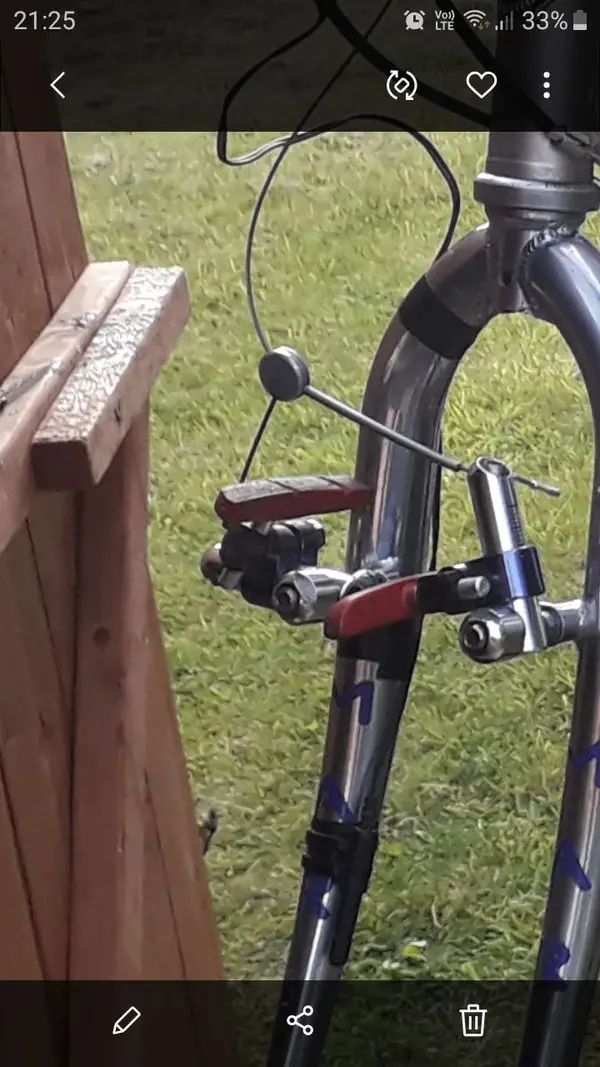

Please can you assist with some advice of brake pads.
I’m rebuilding a 1995 Marin Team Titanium.
I’ve got some Mavic 231 CD rims. The bike currently has Marin Lite cantilever which I may change out to Shimano M900
Which would be the best brake pads. The XTR seem good but very expensive. Surely technology has moved on ?
Advice gratefully received. Thanks. Matt
Yeah thank you.
I’ve read a bit and Kool Stop keeps coming up.
The salmon ones get good comments for anodised rims.
Don’t know if they’re any good and how they compare to XTR
If it were me, I'd look for a set of cartridge pad holders that will work with your chosen brakes. You can then choose the inserts you need and when the pads wear out, slide out the old, pop in the new. M900 and m737 brakes came with these as standard, modern alternatives are available.
Koolstop are the best I've used. Last long, stop better in the wet, don't shred your rims and are reasonably priced. Shimano pads wear very quickly in the wet, with the exception of XTR, which take chunks out of your rim instead.
