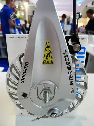

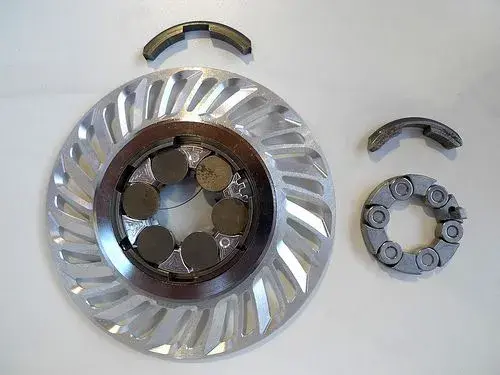

Shimano's 80mm Roller-Brakes are the best hub-brakes currently available. The braking surfaces are under immense pressure but coated with high temperature grease. Because of this they are ultra smooth and silent with no sudden snatching even under the heaviest braking. They have large finned cooling disks that look similar to disk brakes. The modulation is beyond that of any current disk brakes creating what is effectively an anti lock brake system. They are the only brakes that I trust to get me safely down a local hill. None of my friends who use disk brakes have managed to ride far down it, and there is no run out at the bottom so you don't dare let your speed build up.

Below are some pictures of the Shimano IM80 Roller Brake. Riding down my test hill using these brakes is very different from using conventional disk and hub brakes. And It does indeed appear far less steep in photos than it is in reality.
PREPARATION
The main dangers are building up speed that can't then be reigned back in or skidding or locking the front wheel. The slope has some wheel size ruts caused by weathering and front suspension is essential to clear these potential wheel traps. For the suspension to do its job the front brake has to be released and then re-applied. The front tyre pressure needs to be low so as to increase its footprint and improve grip. A dropper seat post and short reach stem are useful in getting the body weight as far back as possible.
The Roller Brake makes no sound in use so all that can be heard is the ripping of the grass under the front tyre and the rear brake has to be lightly applied to ensure that it does not lock as this would lead to a sudden increase in speed. Nearly all the weight is on the front wheel so just as the front wheel touches a rut you have to release the brake. Immediately the speed picks up and for a second your heart is in your mouth until you return to a safe controllable speed. If things go wrong the only safe option is to jump off the back and let the bike continues without you.
