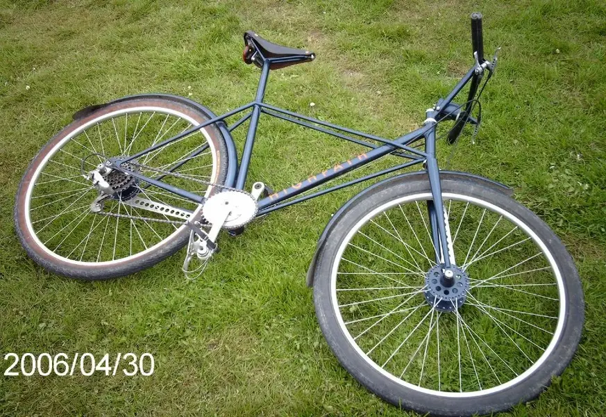

Below is the Rolls Royce of 700c British off-road bicycles. A Highpath Big Blue circa 1992.
You could've warned me - I saw that pic and my Y Fronts exploded leaving my blue veiner in full view and me having to apologise to the Vocal and the chairman of the Rotary.
MikeD":2jw7eghk said:
That Big Blue is completely awesome :)
Some of the advanced technologies on that 1992 bike are only just appearing in the shops today:
*100mm wide bottom bracket shell
*Elliptical chainset with the correct and optimum offset of the cranks relative to the major axis of the ellipse
*700c rims and fat tyres
Features that are not currently available in the shops but should be:
*Drop-swing pedals
*Lightweight 90mm diameter hub brakes with self centering brake shoes
Other interesting features:
*Fully triangulated frame design with asymmetric rear triangle
*Made to measure so seatpost and saddle structures that are part of the frame
*Built in lighting system
