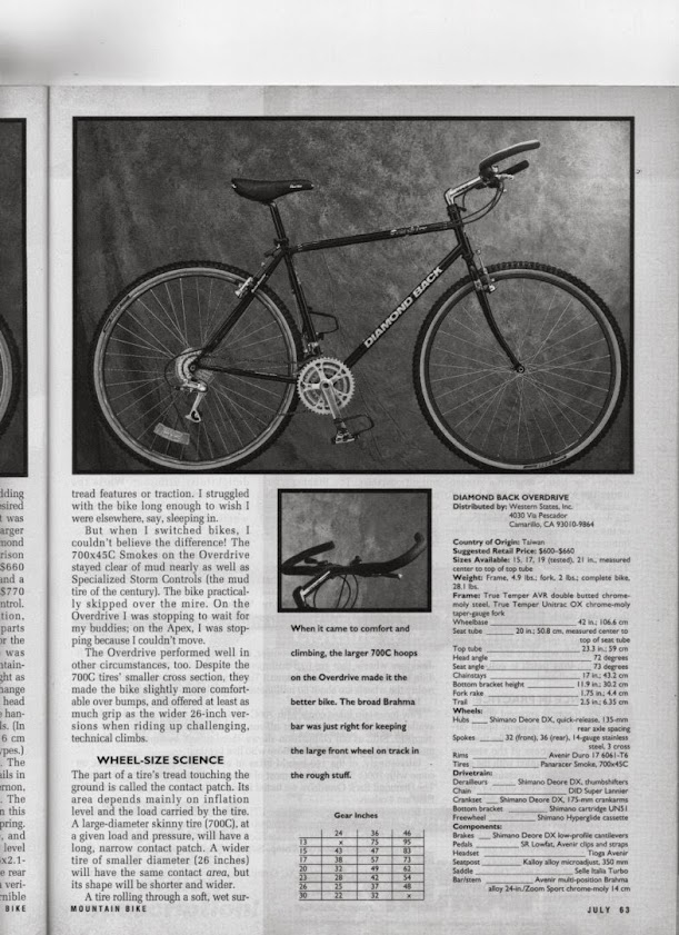

by monutain bike bicycling's of July 1993, one of the first 29er

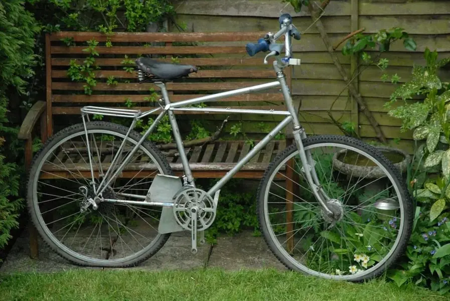

On the subject of 700x47c wheeled Cleland and Highpaths they are incredibly rare with only about five ever made. They date from 1982-1992 and were either prototypes or one off bikes made at the request of a customer. I do believe that there were also some 700x47c cycle speedway bikes made in the early eighties.

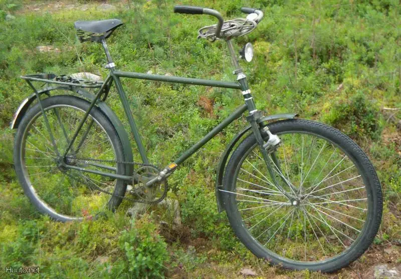

As for a retro 700c bike your best bet is to find a 700c Hybrid bike with good tyre clearances so that it can be converted to off road duties. These bikes first appeared around 1985. Most manufacturers made a version. They were sometimes referred to as CityBikes. If you want pre-retro 650b, you might be able to track down an old Finish Army bike. They were heavy and made to last and were fitted with 650b x 54 tyres. They are still being manufactured today.

Hmm interesting, thanks! Will keep an eye out at the local bike co-op for retro hybrids in massive sizes, as the other options seem prohibitively expensive.
