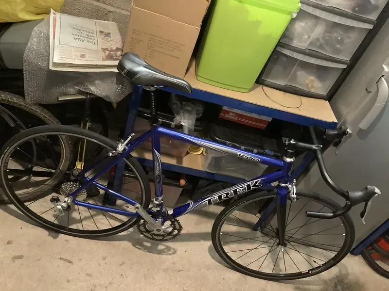

Was going to get it finished today but other stuff has been getting in the way. Maybe tomorrow... Made a bit of progress late last night - nearly there!

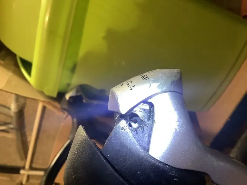

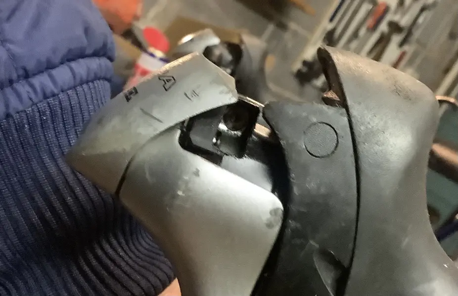

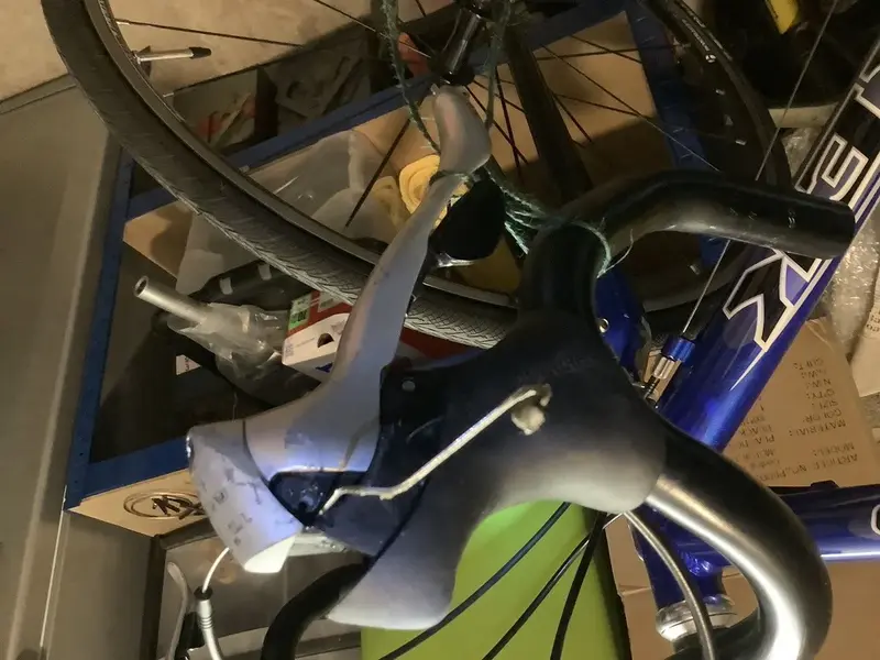

Brakes cabled up and started on the gears. I've a problem with the right hand brifter - the cable barrel is popping out while shifting. Compared to the left hand one (which is a solid cylinder shape) there's something amiss with the socket, although it's hard to see whether this is by damage or design. Clearly it's not right but it looks a bit neat to have just broken.
I've tried to take some photos of the issue but struggling to get a clear one. Am considering gluing the barrel in place to save having to replace the unit.

Sorry about the blurry upside down pictures. Here's one of the LHS.

Well... in the end I just took a punt on some secondhand brifters off eBay. This has turned out to be an expensive rebuild.
Good news is although the cable anchoring bits look the same as the old ones the replacement r/h unit works OK. Not sure what (if anything) was wrong with the original. I might just have been doing something silly.

I think the cable problem (if I understand your issue right) is that it needs the constant tension of the rear mech. If you try to exercise it without the mech spring pulling on the cable it all goes horribly wrong.

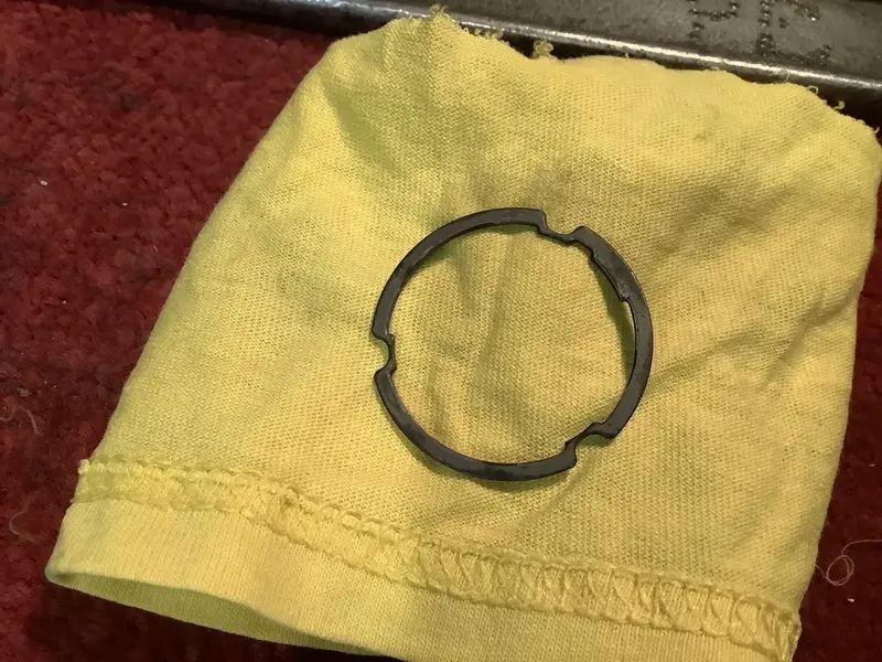

Found a spacer attached to an LX parallax hub.
OT: They always seem to have one and I haven't really worked out why. There IS limited wiggle room to get the tool engaged to get the cassette lockring off without - maybe that's why?
Anyway I find them more useful for adapting modern 10 speed wheels for 8/9 speed use...
Job done. Also tweaked rear mech. Nice quiet precise shifting in the stand. Tweaked a spoke or two on the rear wheel while I was at it.
Got a bit frustrated with the chain - sizing with a short cage mech and wide range cassette is tricky. I feel like it could do with another link removed but it would be bloody tight on big-big. It's ok as-is. In the pic above it's on small-small - chain is pretty slack but -just about- held in tension by the mech springs.
Not far off perfect now, minus bar tape...
