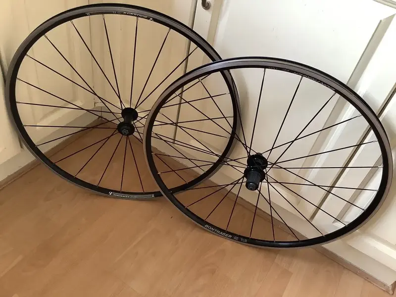

Wheels are here. Not all that excited by them in the flesh - they're a bit mass produced and modern looking (what did I expect?) and not staggeringly light... I'm sure I have 90s MTB wheels that weigh less... maybe not. Spokes seem to have some corrosion under the paint but otherwise seem in pretty decent condition.
Still I think they're OK for what I paid, fairly appropriate for the bike, and they'll get me on the road. Maybe I'll build something nicer myself if I like the bike once it's ridable.

Those are bottom end modern Bontrager - but the bike would have been supplied with the period equivalent "Select" wheels.
I upgraded mine - several times - and so have a selection including XXX Carbons :)

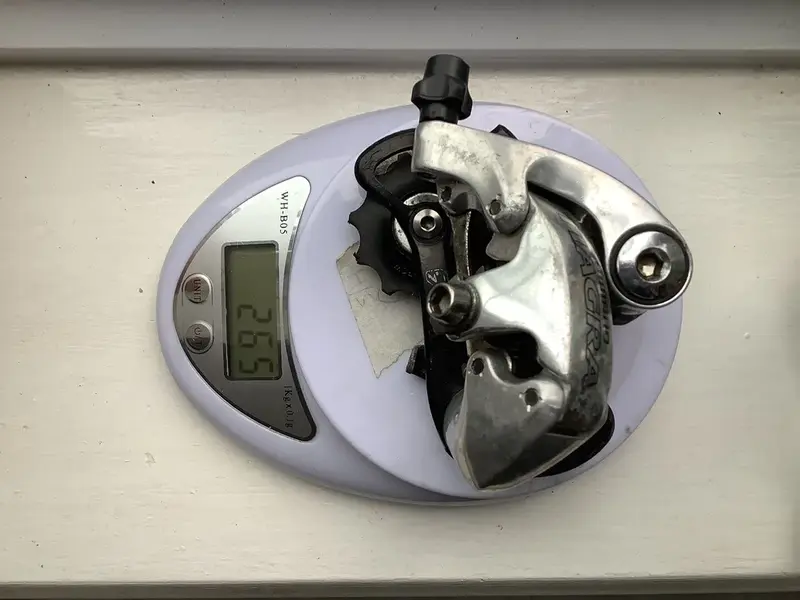

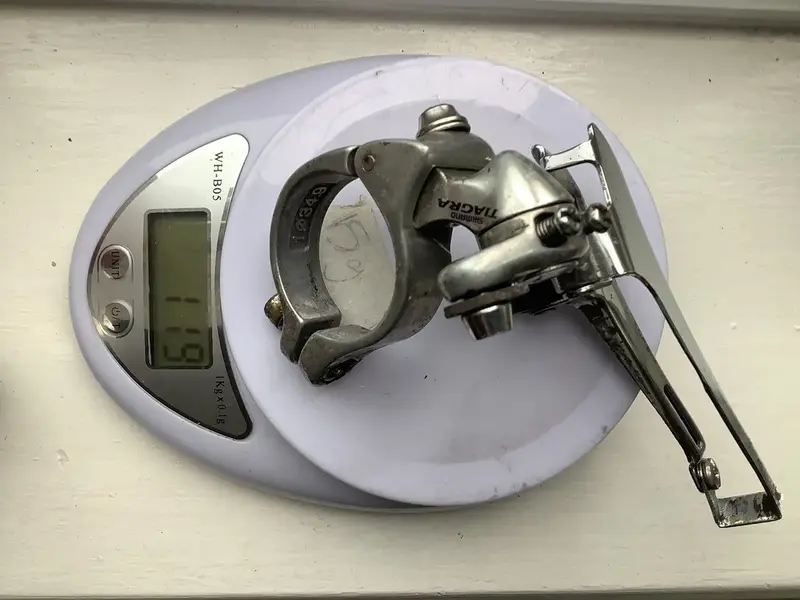

Had half an hour spare so cleaned up the mechs. Both in decent nick, not too heavy IMO, and not even bad looking this generation of Tiagra.
Assuming they work OK with the cassette I've got no plans to change them... might give them a polish, mind.
