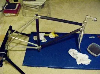

I got to thinking about it and decided to really give the bike a make over. The aluminum had (has) a lot of scratches so I'm going to polish it up and really clean the whole frame. I've already taken the big scratches out with 100 grit and now sanding with 220 perpendicular to the original, continuing until I get to 1500 grit. Some polishing compounds are on the way... this is going to take a while :roll: but should be worth it. Here is how she looks now...

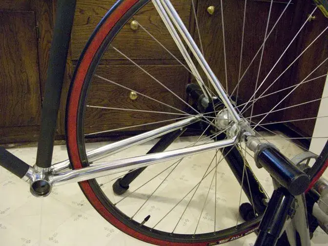

Bike buffed up now...

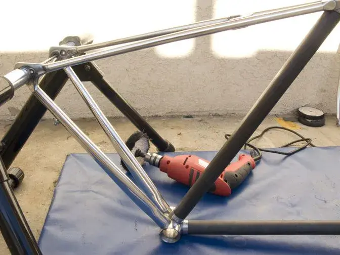

So it has been a while. Wet sanded from 100 grit to 1500 grit, which took quite a long time. Got some buffing wheels and used jewelers compound to buff then a rouge to polish. Here is what that looked like:

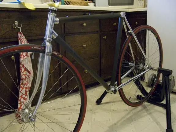

Still going...
I've actually got the decals, brakes, bars, etc on and will post some pics of that soon too!
