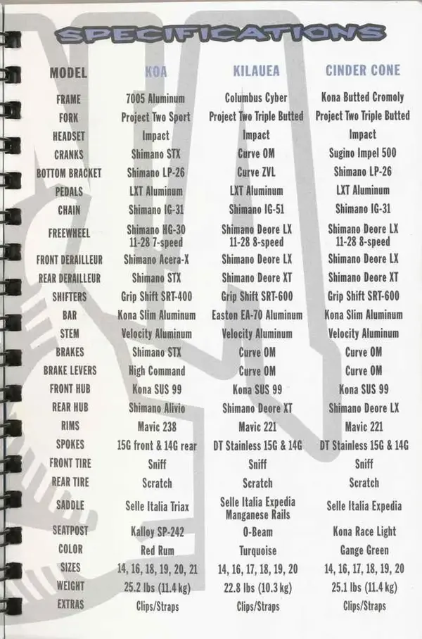

Hello and welcome to Retrobike.
With a quick glance, there seems to be very few original components on your bike, but you do have some key OEM parts: Project Two Triple Butted Forks, Impact Headset, O-Beam Seatpost, Velocity Stem - from what I can see, the remainder are replacements.
So you figure the groupset has been replaced as well?
You can view the original components that were fitted by referring to the 1996 catalogue listed on this site: here
..... and here is the relevant specification page from the 1996 catalogue:
Pip

Hi and welcome to the forum.
A nice bike you have there, they are great riding frames.
Like pip has already said, the original parts are the frame, fork, headset, stem, seatpost and by the looks of it the front mech, also of course the seatpost clamp and dog collar. As is the case a lot of the time, the catalogue specs are not always reliable, the front mech was a Sachs, used on a few of the range. I have one somewhere, also the Curve brakeset taken from mine back in mid '90's :D

Dude, thanks - I've been looking for a list like that with no avail!
