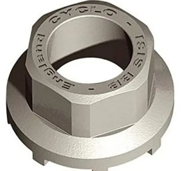

If you turn it over you will see a nut that holds the ring onto the crank. Before undoing the nut there is a wire clip that needs to be removed first. There is a special tool for the nut, although if not too tight there are some "alternatives" involving a hammer, bear in mind the nut is alloy.

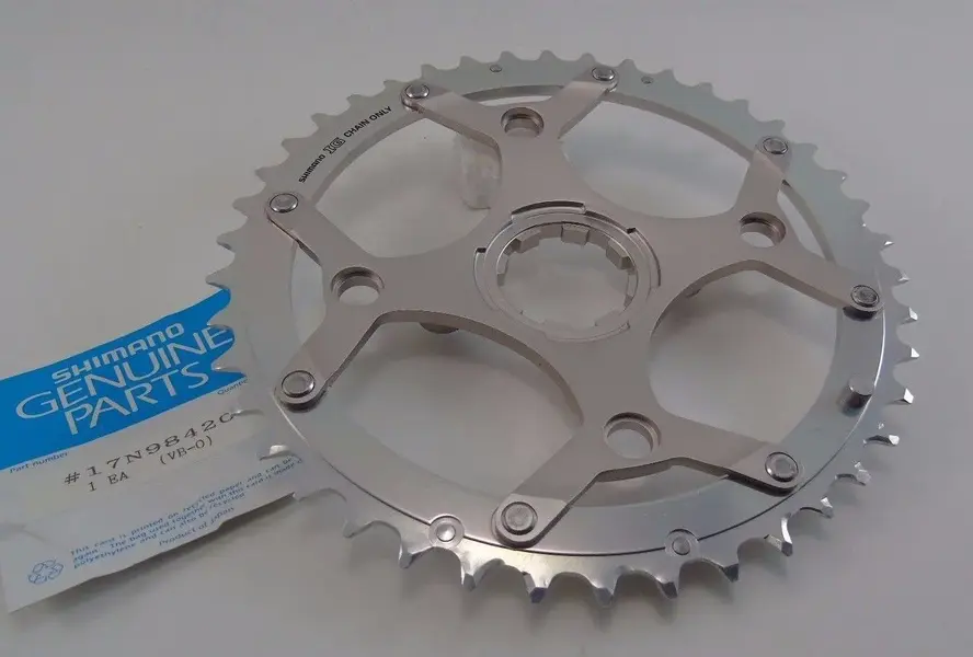

As to replacement, you can either buy a replacement chainring on a like for like basis, the m579 set has same arrangement.
There is also a 5 arm spider that was available (I have on my DEAN) and converts crank to a five arm arrangement.

Don't cheap out on the removal tool. Do it right as if you mess it up, you will need a new lock ring too.
As above re. rings. Lx or xt replacement, or find a compatible spider that allows you to replace just the rings in future.
Pretty sure it's the LX M569 outer ring (several on the bay) would correspond to your XT M739 - think daugs made a typo.

The spline pattern for the ring (or spider) is the same as xtr m95x, but not sure if they would fit directly due to the extra tabs on the crank arm that fit into the correct ring/spider.
I just sold a set if xt cranks with the 5 arm spider, I'd check and confirm otherwise, as I have 94 and 104 bcd spiders for m95x xtr cranks.
