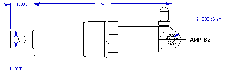

Unfortunately that's the wrong fit. The RM Edge is of the AMP B2 design and would require the same shock. Per Risse's site the beast you require is a Genesis Damper in this configuration:
I've a load of AMP and AMP-derived frames and have done much business with Risse. A good bunch of guys that provide top-notch service at a fair price. I'm pretty sure standard shock overhauls are only about US$35 + S/H, and I'm sure they'd have no problem shipping abroad.
