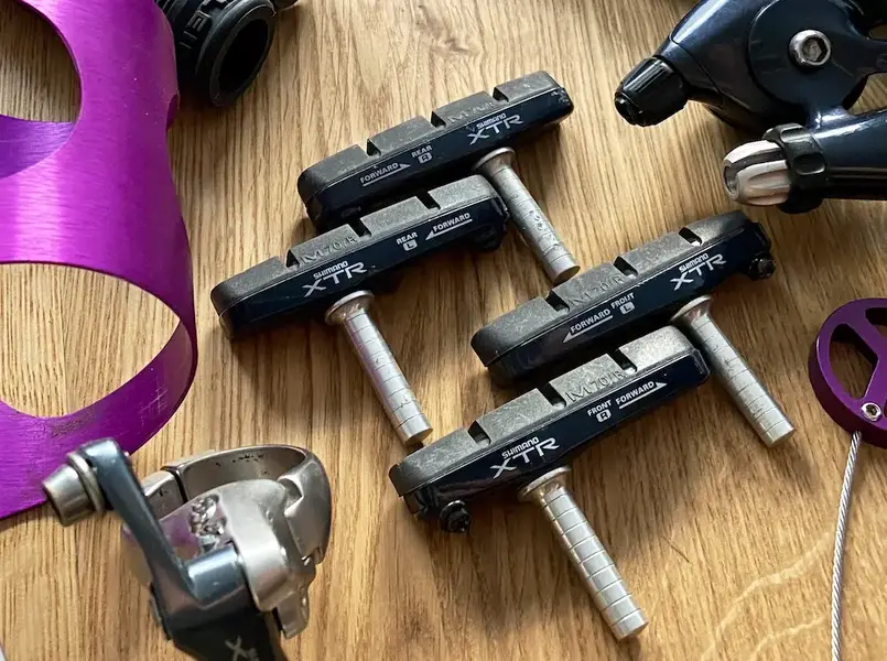

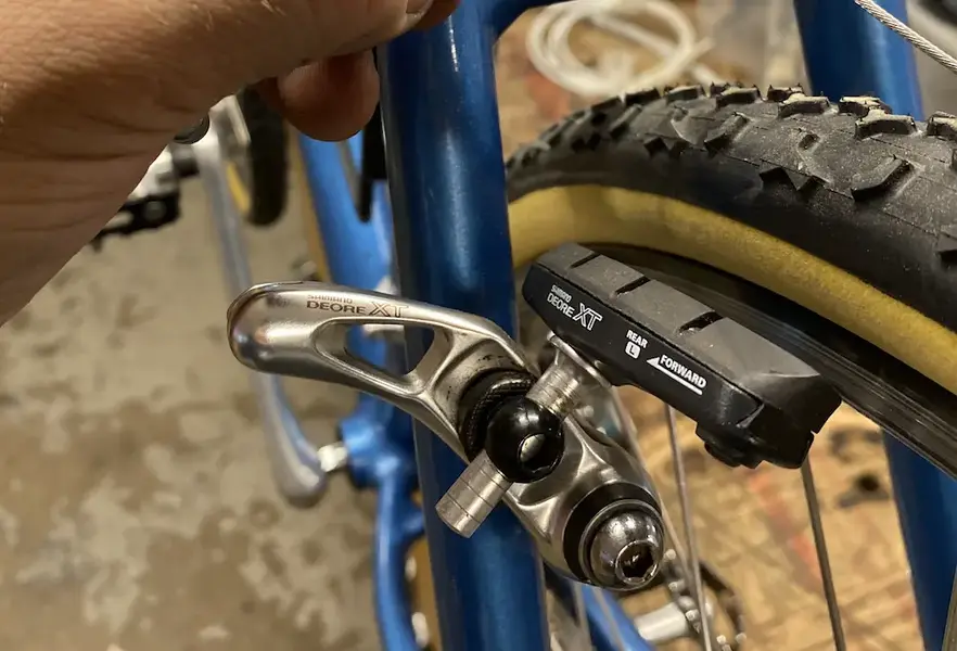

Yes, XT M737 pads and XTR M900 pads are slid-in and secured by a tiny screw.
