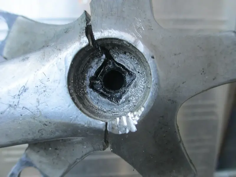

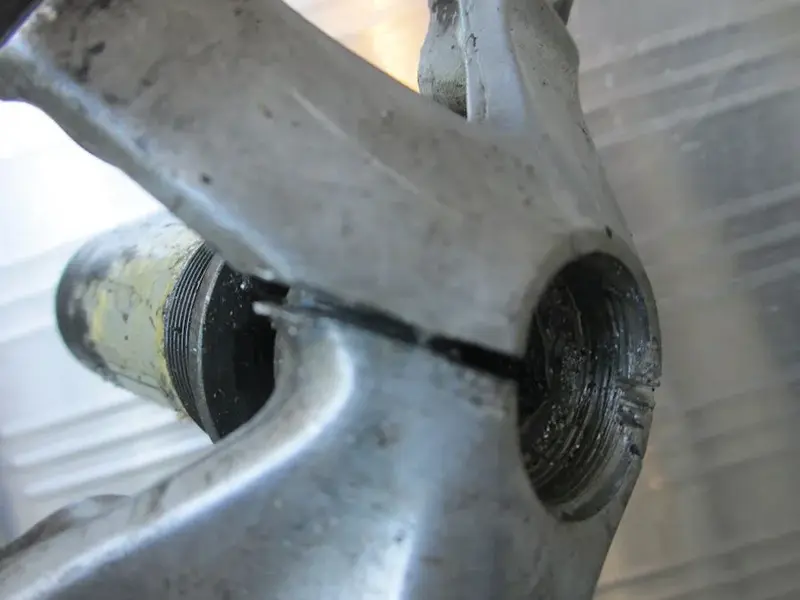

Aside of last resort destructive methods, loosen the crank bolts and apply lube of choice, then go for a good ride. The pedalling and vibrations frees the cranks to the point of wobbling off – just keep the bolts in but loose.
This has worked well on previous occasions with other cranks, but not with a nice pair of old Suginos unfortunately – only the left crank came loose and was forced to hacksaw the right crank down to the bolt.

if you get to the cut off stage, a dremel with metal cutting disk will do it. One bit of advise is to put some sort of wood or protection between crank and frame, you dont want to slip and hit the frame. I cut a drive side off an old frame and it took a while but removed it and the frame is still good. I narrowly missed it with the tool a couple of times and then protected it.
Very good point – should've added that. And particularly if a rubber mallet is involved at some stage (not advised).
