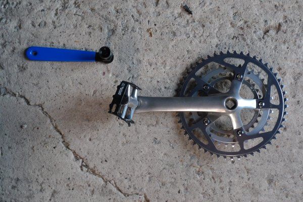

I hope this may help someone, now I've now proved scientifically that bike tools are actually rubbish!
Park tools crank puller, cost £15.90 from evans: Score +1

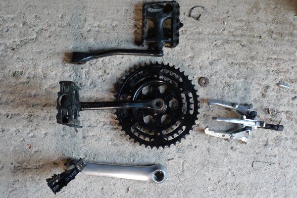

Hilka gear puller, cost £14.99, Screwfix # 12510: Score +3
Cheaper than binning a crank with a stripped thread, and better for the environment.

Ive also looked at having a gear puller around for just such emergencies but i know someone with one :D
+1 for gear puller.
car ball joint splitter
