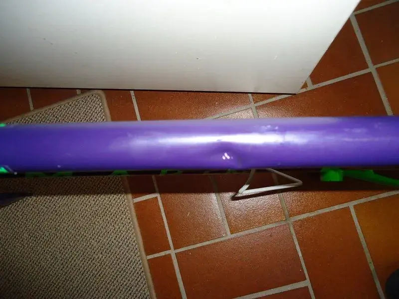

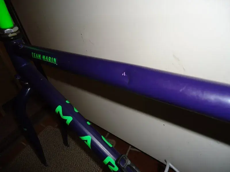

Hi
I have the same problem with a Marin Team 1992 basicaly the dent is same place on the top tube looks as though the handlebars made the dent... :x
Rest of the frame is in good knick so hoping to also remove dent or at best reduce dent :P
@Ratbane ...How did it work out with your Kona frame ?
Let me know if it would be better to open a new thread ... :?
Here are some pics of the dent in my frame ....
