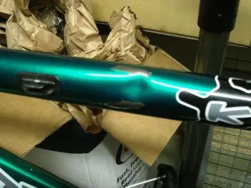

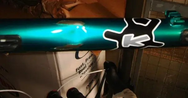

Before and after shots here. I applied ice around and in the dent for around 30mins. (was abe to use a chunk of ice from the duck pond!!!).
In the flesh it feels/looks like it has had some effect, but I'm not sure about the picures showing that.
I'm going to try the CO2/hairdryer method on the weekend.

You'll never get that out without mechanically damaging the tube imo. That is quite a dent, which has stretched the top and lower vertical plane either side of the dent - which is why you have the paint missing there. If it wasn't structural, such as a car panel I would tap the high points with a polished panel hammer, then fill the remaining dent. Unfortunately, hammering the high spots will stress and possibly crease the steel - weakening it potentially. Adding brass filler braze will also weaken the tubing here. I think it is worse than you may realise.
Me, new tube at Argos or ride it as it is.
