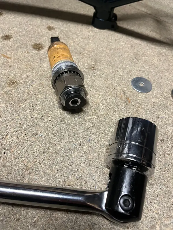

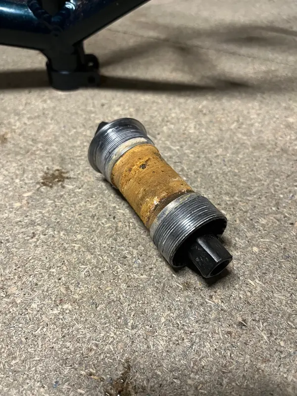

I can strip a bike down completely pretty quickly but this one...this one really wanted to make my life difficult. Now I've had stiff BB's before but this thing was absolutely jammed in there and wouldn't budge so after a quick search on the net I came across a great little tip, bolt the removal nut onto the BB and use a lot of elbow grease. Some of you probably know this from experience but I've never had to sweat to take apart a bike before. Here's the results after using all my strength with a breaker bar. That deserves a beer, this weekend I'll begin on the stuck stem after a week of soaking it with penetrating oil. Hope you find pleasure in my misery.
