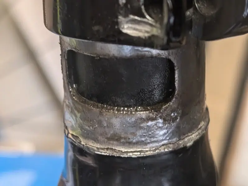

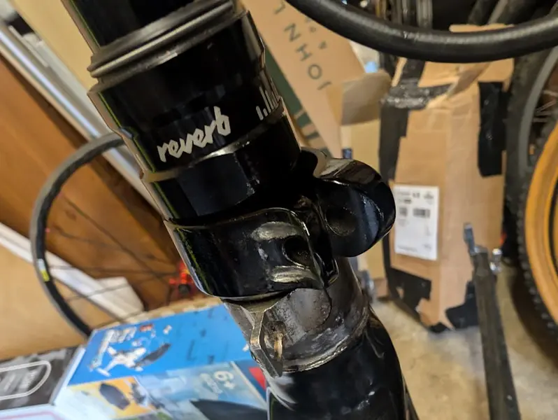

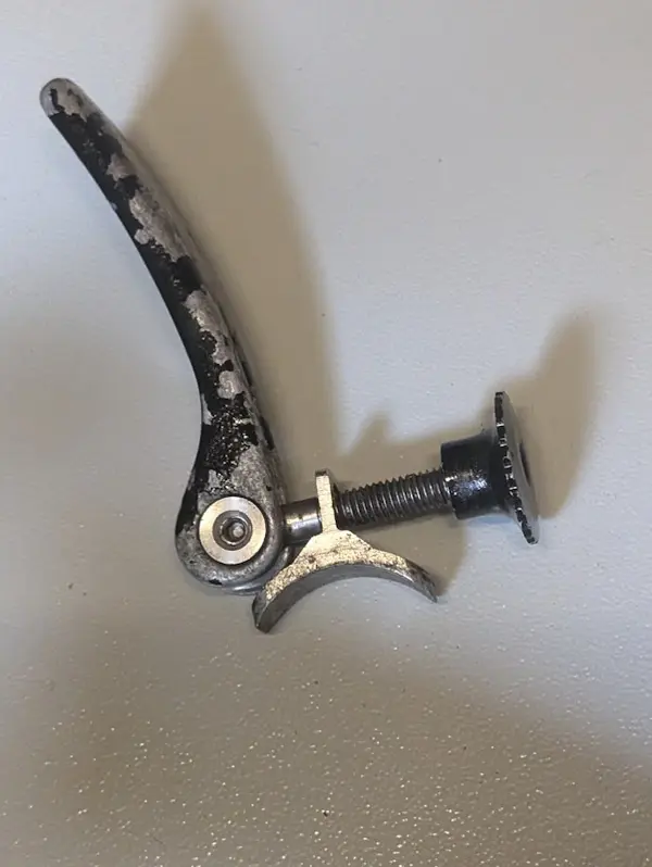

It has this weirdness.

So they decided the wheel did need redesigning after all!
Looks like some ally corrosion though.

Yes, all seems rather over engineered to clamp a post when a slotted tube just works.
