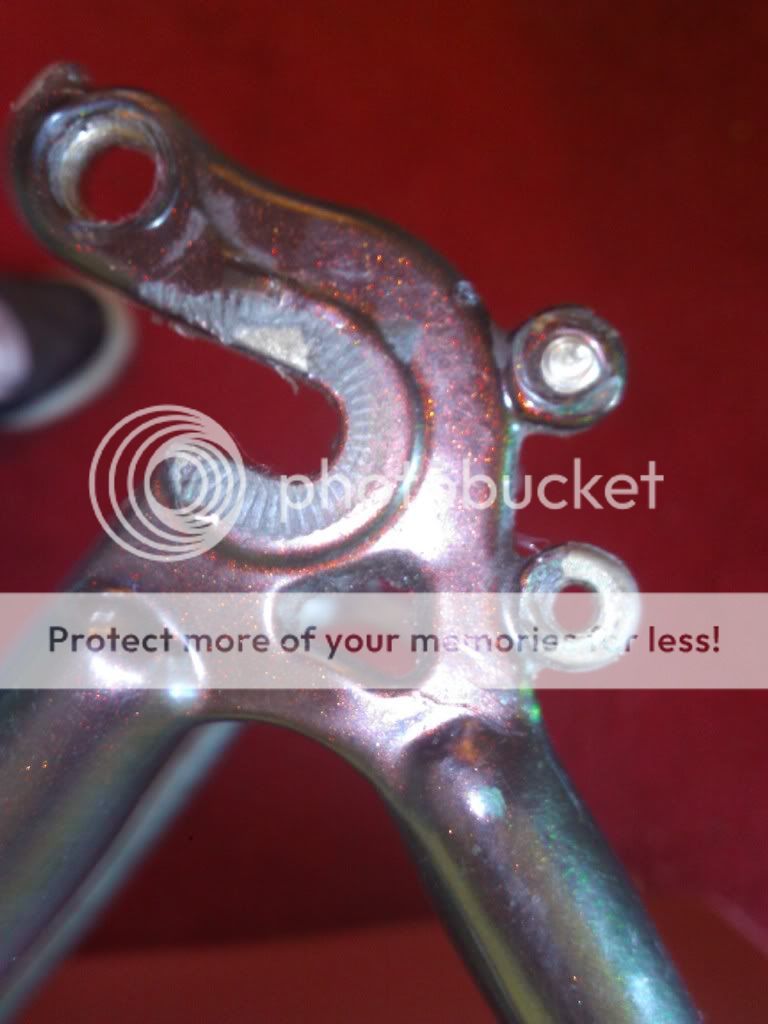

I have just received a frame I bought off ebay unfortunately there is a sheared off bolt in one of the braze ons for mudguards and pannier racks. Is it possible to get this out and still have usable threads left
Thanks
Alison
Here is a picture

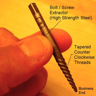

Get a screw extractor and wind it in slowly, by hand. As it bites into the broken screw, it will wind it out of the frame: Job done.
Those extractors DM mentioned are very good. Do they make them that small though?

you should be able to get an extractor that small - i used them alot on snapped cantilever boss bolts in the workshop (M6), i'm sure there was M5 too. drill a small pilot hole and wind the extractor in. Caution though, if you attempt one of these and the extractor snaps in the drilled bolt then you have a problem :wink:
It might be a bit small for an Easy Out bolt extractor, I don't have one that small. A left handed drill might spin it out.
