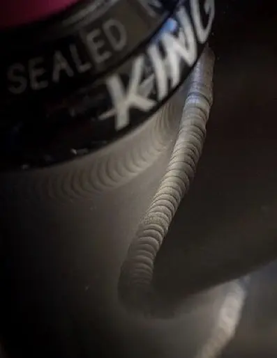

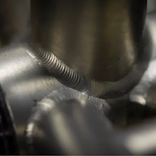

Perfect Ti Tig welds on a 94 FAT from an ex MIT, NASA Certified welder ;) His neat coin stack welds are works of art and what drew me to the brand when i first saw them back in the late 80s. There is virtually no margin for error with these. If you cock up its ruinously expensive to scrap Ti frames. It amazes me just how strong yet comfortable these frames are.
