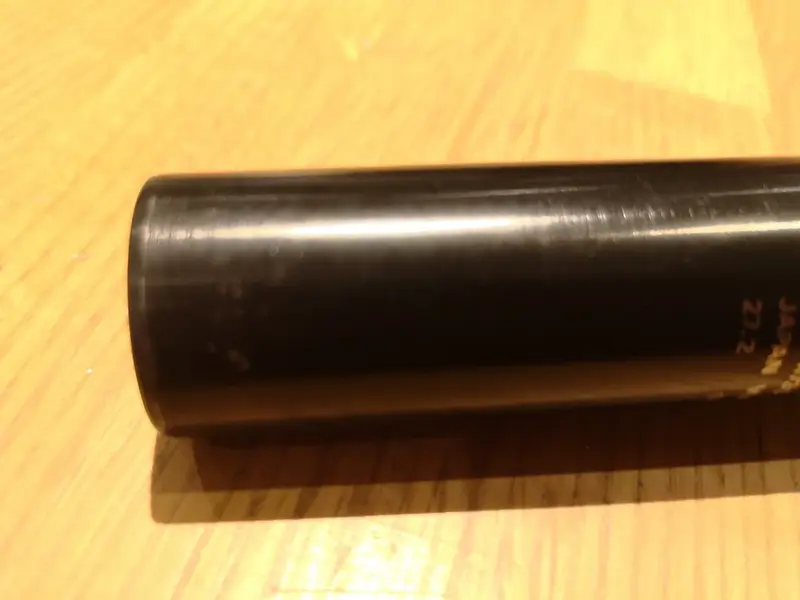

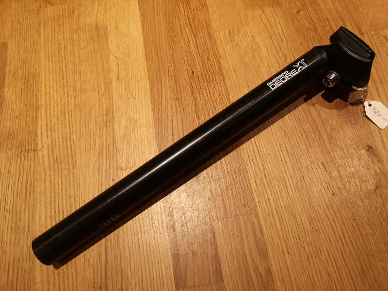

Just looked at my NOS one and you can actually feel little tiny burrs on the surface like the turning tool was a bit blunt or cutting speed too slow.
I think most materials can be anodised, from an alloy mix with steel to copper, most nonferrous materials can have the anodising process done. I could be wrong, does the Shimano technical data sheets state on the finish? Does a magnet stick to the seat post?
I think most materials can be anodised, from stainless steel to copper, most nonferrous materials can have the anodising process done. I could be wrong, does the Shimano technical data sheets state on the finish?
Anodising is increasing the oxide layer, on aluminium this creates a hard surface on an otherwise soft material. Trying to oxidise steel just creates rust.

The seat post has no rust on it though, am sure it has had an Arc coating during its process from the factory on creation and finish, if its steel. (I could be wrong though)
I said: "In a perfect world!".
... where the post is made of alloy with a steel head
