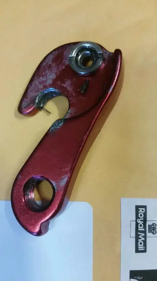

Cheers for the replies. There is definitely slight fore/aft movement of the mech hanger, not a huge amount, but if I loosely fit the QR, I can still move it. With the QR tightened properly it doesn't budge by hand, but perhaps under pedal power it could move. I've ordered a new one, so I'll see if that makes a difference. I'll report back once it arrives. The one fitted is original, maybe it's worn? I hope it's not the frame of course, but it doesn't look to be by eye.
Have you got a better pic of the dropout, it looks like the spindle has been moving around.
What is the fit of a 10mm rod like in the drop out?
I had a frame which the spindle had been moving around. I put a cap over the axle and got rid of the
titanium skewers infavor of some steel shimano ones and it stopped it.
If the dropout won't tighten it sounds like you have come to the end of the thread!

I reckon this is the cause of the problem too.
Ian, Is your Gear Hanger Bolt similar to a Chain Ring Bolt, and has it bottomed out on the "nut" part on the inside of the Dropout?
See example of similar:
Pip.

Yes, same type of bolt arrangement as a chain ring, and it hits the end/bottoms out before fully tight.
So just shave (file) a bit off the end off the male part of the bolt and all should be good. Its possible the original bolt was lost and it was replaced with a double, instead of single chain ring bolt, which is too long

I've got a new bolt set on order too, but it definitely looks like a single rather than a double.

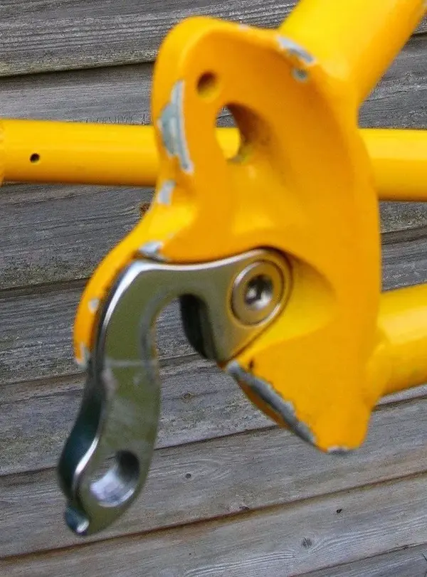

New bits now fitted.with the bolt loosely tightened, still a little bit I've movement in the hanger, but less than the old one. Once fully tightened up, it doesn't move at all, and with the wheel QR tightened I'm assuming it's not going to to budge, would I be right? Pic of the 'gap' between hanger and frame below.
The old hanger does have some wear from the axle so hopefully the new one has solved the problems.
Any thoughts on whether I can now forget this and move on with the rest of the build, or should I still have concerns?
