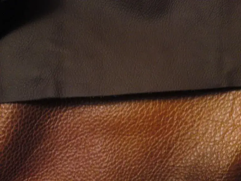

the tricky part is actually to find a suitable piece of leather !
it should not be too thick (so the front and sides are easier ) but not too supple too so that no creases are created.
managed to find a couple of pieces ( one of which creamy white perforated 8) perfect for the breezer lightning)
