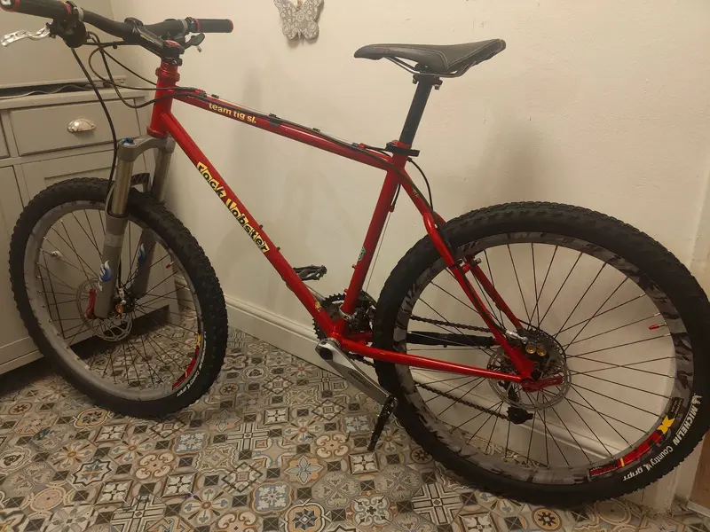

Rebuilt 2002 Rock Lobster 853
I had 2 piston mono minis on front and back and the M4 rear brakes came in a box of bike bits I picked up, rather than leave them there I bled them put news pads and fitted them. I'll be after some M4 for the front soon though

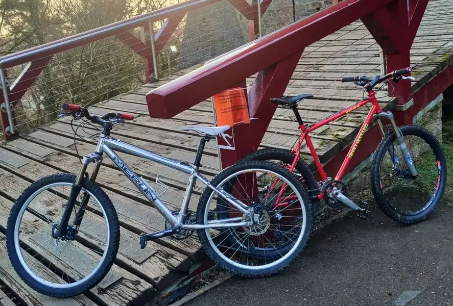

Went out with my daughter yesterday for a 9 mile ride and bike rode really well, even the massive incline up to the Castle.
Daughter loves her Merlin Malt, built that up for her 2 years ago after picking it up for £100.
Only thing it's had is a new Charge Spoon seat to match mine and some new Deore disc brakes as the Magura Julie ones on there were rubbish.

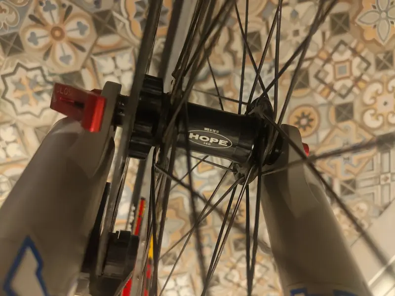

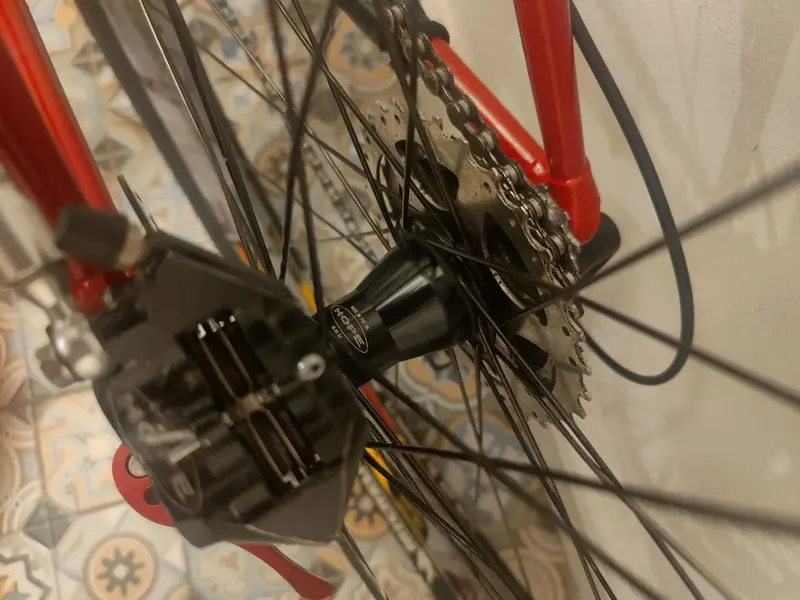

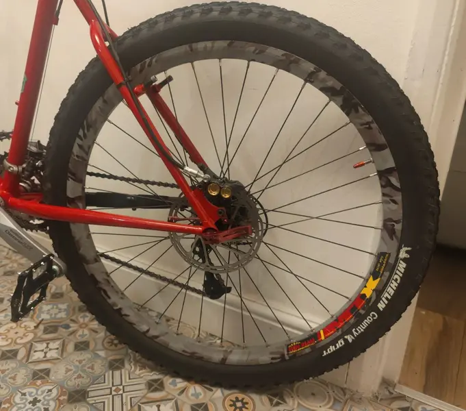

Saw a nice pair of Hope XC hubs laced to Sun Rims on the old Gumtree the other day for a decent price.
Got them home and decided a full strip of the hubs was needed, thus started the issues.....
Didn't realise when I bought them that the rear skewer was stuck tight inside the axle and wouldn't budge at all.
Quick trip to the hardware store for some punches to start me off.
I cut the skewer off at each end where it entered the axle and set to it with the 8mm punch.
An hour later and game on!!
I must say, the strip and rebuild was very straight forward and I found some good guides online to help me out.
Some nice new bearing have gone in too and it's running super smooth.
Put the cassette, tyres and brake discs on and we're up and running.
Really happy with the result and got so much more confidence in the wheels now to chuck it around more with spring quickly approaching.
Watch this space for the next update, it's bound to happen sooner rather than later!!

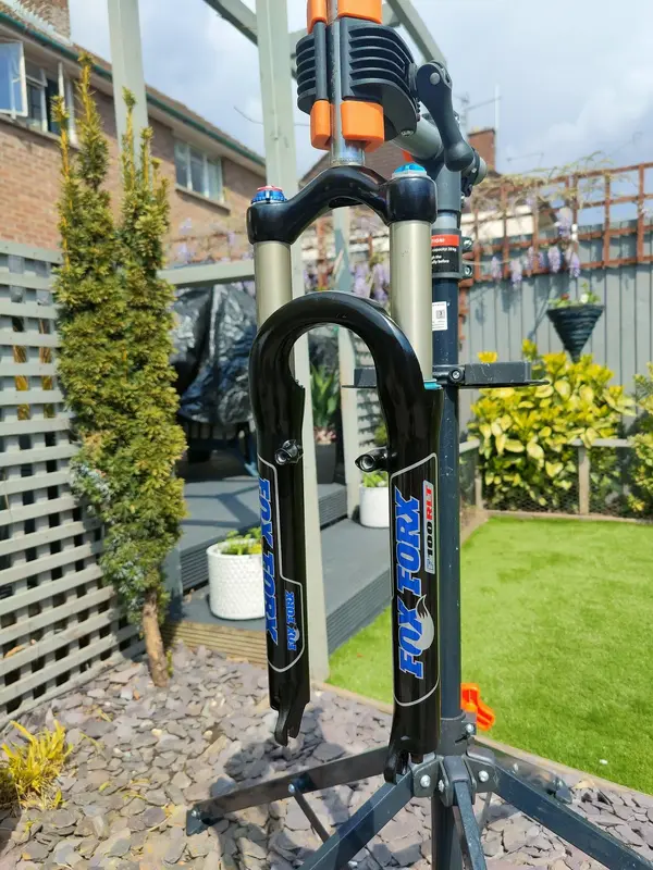

Had a bit of a mare 2 weeks ago.
Been getting a bit of fork judder under braking at low speed, tried headset tightening, brake pad adjusting and rotor change plus tighten, just couldn't get rid of it.
Only solution left was to tighten the lower bolts on the TALAS forks, big mistake as I sheared the bolt right off, forks now dead!!
NEW PROJECT TIME!!
Managed to get a second hand pair on Gumtree of Fox Float RLC with 100mm of travel, better suited to the geometry anyway for a steal.
3 hard days of work including a full strip down, sand and spray with new stickers and dust wiper seals and they're amazing.
Only issue, still got the fork judder, any suggestions?
I've even replaced the headset now and still no better.

Front wheel hub ?
I can't see if you've got a spacer on the top of the stem or just the cap.
Try and remove a red spacer and place a black one on top of the stem and then the cap. I had a similar problem and it solved it.
If that doesn't work, I can only think that the fork crown isn't seated properly.
