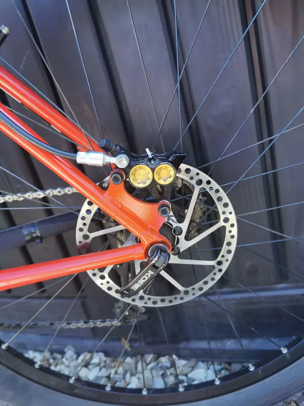

Bit more fettling today!!
Realised the Deore brakes I had on there didn't really do the bike justice and needed something a bit more retro and classy.
Only one answer for it, take the Hope Mono brakes off my GT I-drive and swap them over.
Bit more than just changing over though as the discs I had with the brakes were slightly out of shape, a vice and mallet later and job done.
What a difference, much more powerful, easy swap and got rid of horrible adapters.
I think you'll agree they look the part too

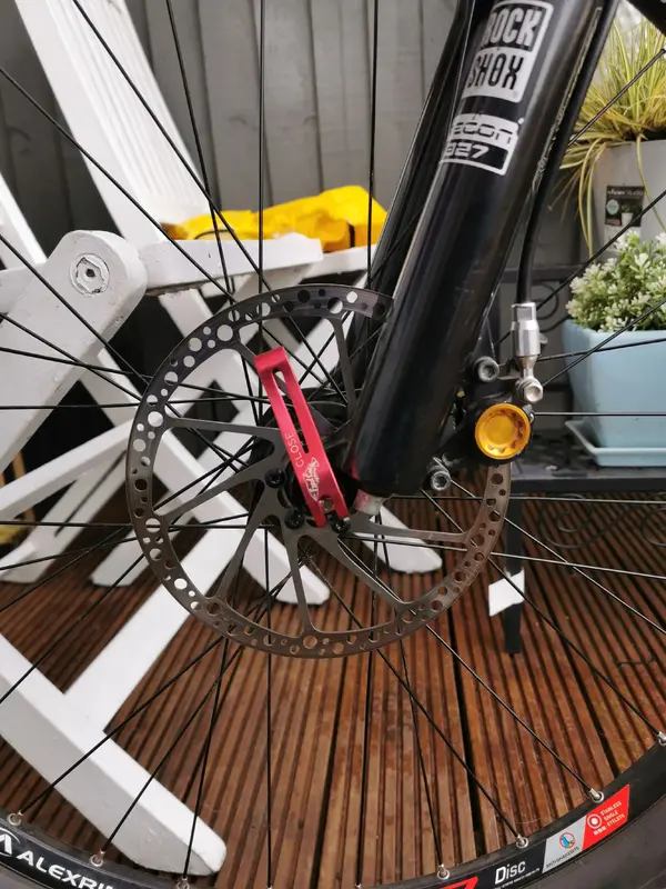

Cheers mate, just need to think the forks.
The 130mm travel Recon 327 are OK, but rather go a bit shorter I think.
I'll fit the Hope headset and Head Doctor when they arrive then make a decision.
Shorter forks would be more in keeping with the era, unfortunately less fun though

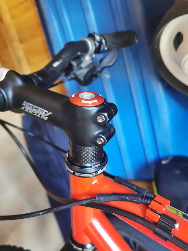

Finally getting there now I think!!
Added a 2nd hand hope headset that I picked up off Gumtree for a steal as well a s a brand new Hope Head Doctor to tie it all in.
I don't think I'll ever use a star nut again, these just feel so solid in the steerer tube and the solid feeling gives me great confidence!!
Pic attached, I think it looks really nice, black would have been better but they're like gold dust.
I honestly can't think of anything else I want to do to this bike now except ride it, although I'll probably keep playing with things when I get bored.
