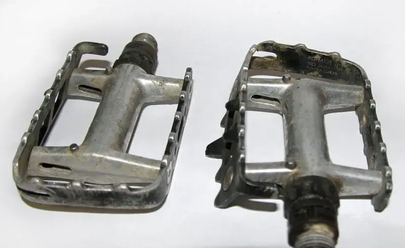

rebuilding xt m735 pedals

Unfortunately I bought these disassembled, so didn't have the opportunity to carefully remove in order, so its possibly they were incomplete.
I thought the bearings were just 3/32" ones, but no idea how many each side.
More of a puzzle than a rebuild.
Once I get these together I should probably do a youtube vid on what, how many and how deep the bearings go (unless anyone's done one already.....)
I can see why the cartridge system is a vast improvement!

Ordered the seals and new bearings, so will give that ago.
in the meantime, found a set of later Cartridge axle M735's on fleabay
These will be a lot easier to service!

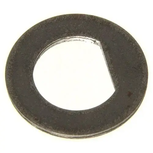

There is a way you can cheat this by grinding a flat on the thread and using a D-washer between the locknut and cone (as long as you're happy to slightly bastardise the pedals). Lots of other pedals utilise this method. You can make a washer that will act as a D-washer with a standard washer and a centre puch.
Hmmmm.. good idea fella, I could have all the parts machined as well... 8)
Cheers
G
