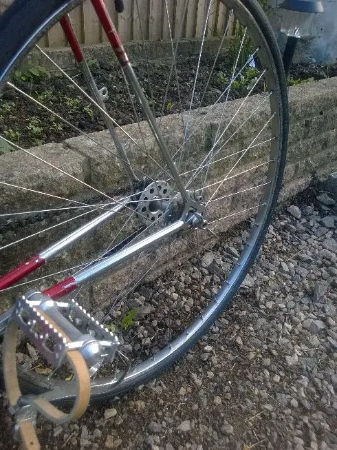

As found 53 Sun Manxman rear. Racelite hub. Nice to see your here Keith and hope information will never be lost.
Simon

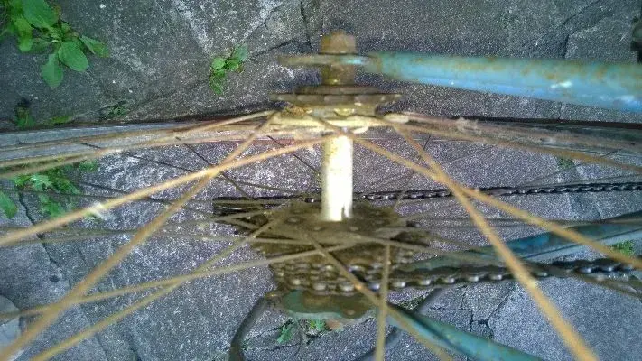

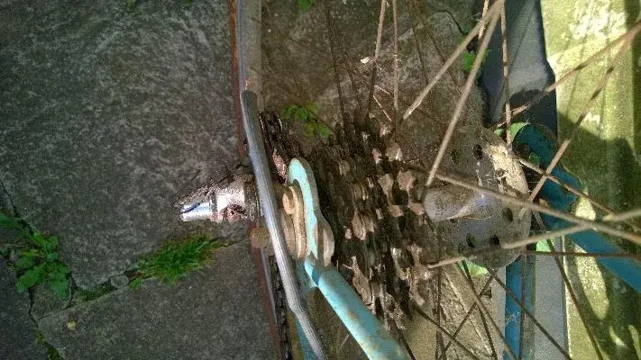

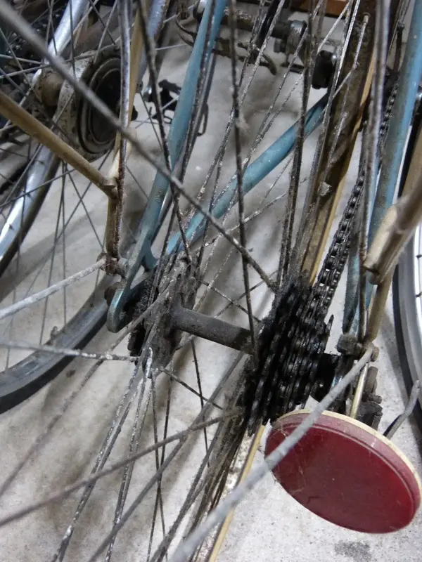

I picked up a Holdsworthy (I think it is a 1952/1953 la Variable) last weekend with a similar setup as Simon's Manxman. I will attach a terrible picture to show my setup (uncleaned and in a dark garage). At the moment it has a 5-speed block and Sachs Huret RD.
The previous owner (from new) gave me a shoe box with bits and bobs, in which I found the original Cyclo Benelux RD :D .
Marked for 3 speed 1/8" - but I assume it was setup for 4 speed 3/32" when it left 132 Putney. Am I right btw that I can modify a Regina (or other brand) 5 speed block to 4 speed simply by removing the smallest cog?
The original questions remains - what was involved in going from gear (multiple speed) to fixed? I could imagine something like using 2 masterlinks to make it easy to adjust the chain length - but would they remove the derailleur, gear lever, rear brake as well?
