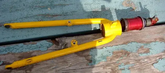

Oh yeah... boxcrown Fat Fork in the background (cool gussets, huh?)
