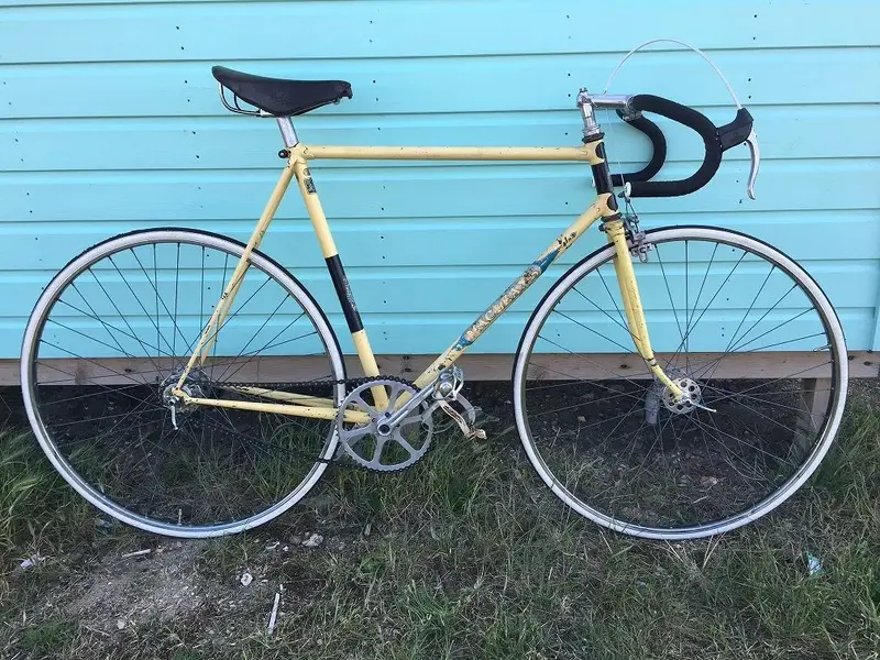

I too was going to suggest a Road/Path frame. My 1950 Macleans Featherweight is virtually the only bike I ride nowadays. Good job there are not many hills in Southend-on-Sea!
