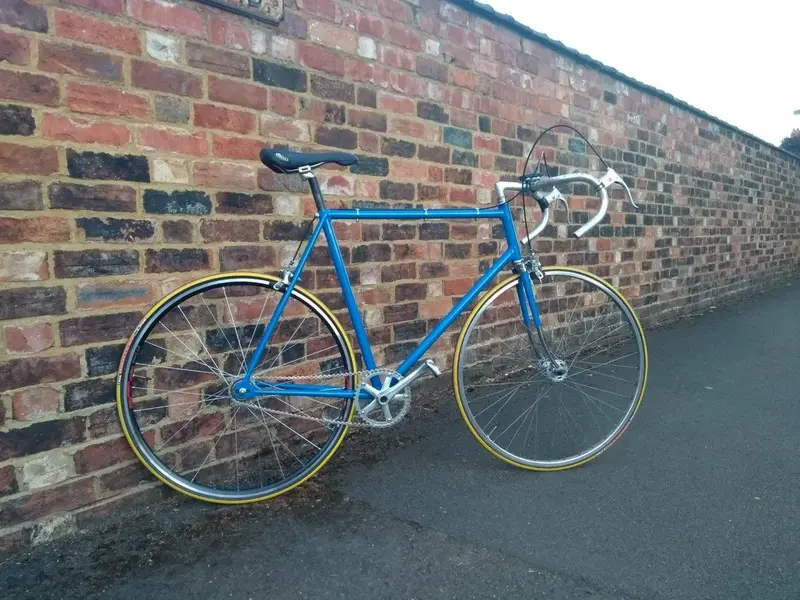

I have a 1970's Woodrup track frame that Lee Cooper replaced the rear bridge on and renovated the paintwork at the same time . With the right gearing nothing to stop you from using it as your main bike .

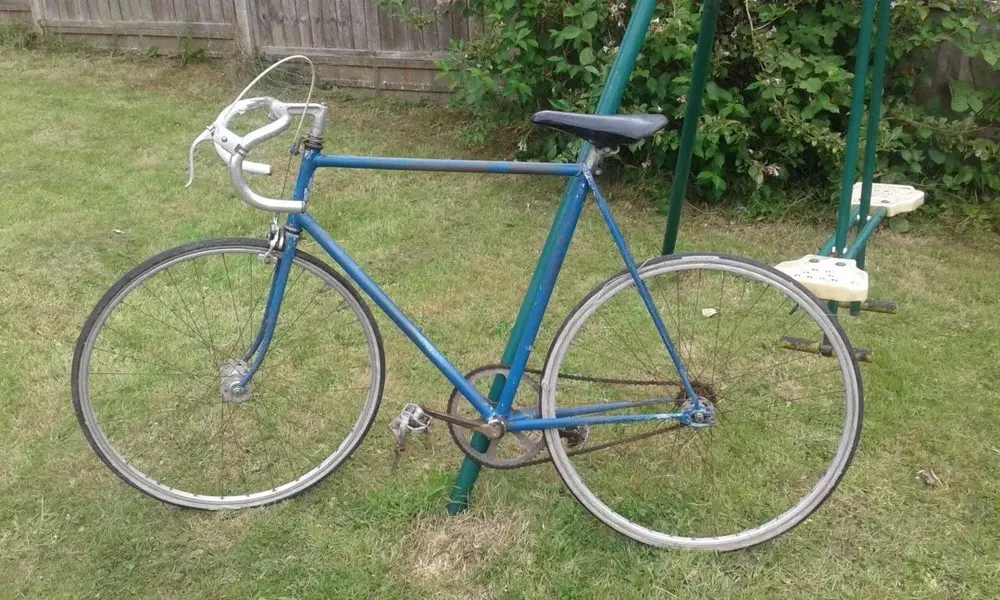

I also have thus unknown frame waiting in the wings
