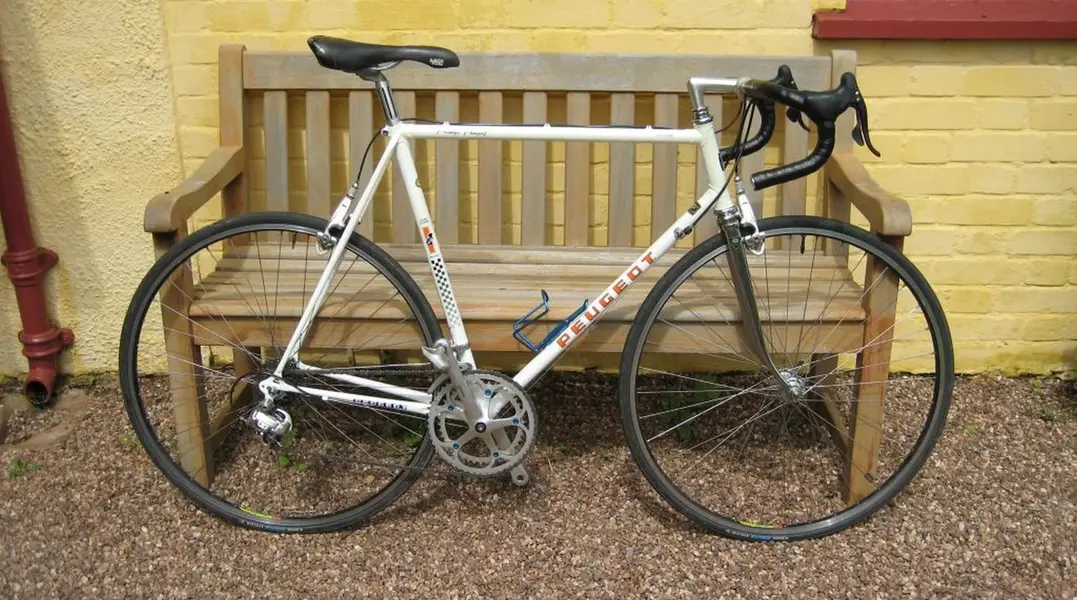

My last bare metal was this with a pearlescent lacquer over the top - I had some left and ended up using the pearlescent all over the place
