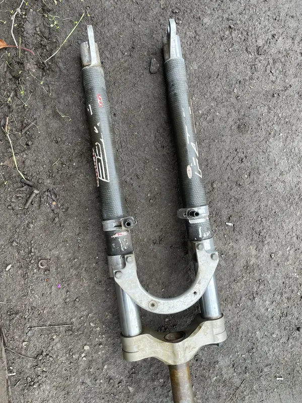

Hey folks
Found a shitty bike on Facebook yesterday with a tasty front end. Took a gamble and… it’s not as much as a bargain as I’d hoped.
I didn’t notice the RC36 was missing the rear brace, so I need one of those.

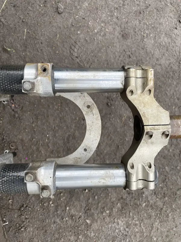

I did notice the brake posts have been flipped to the front.

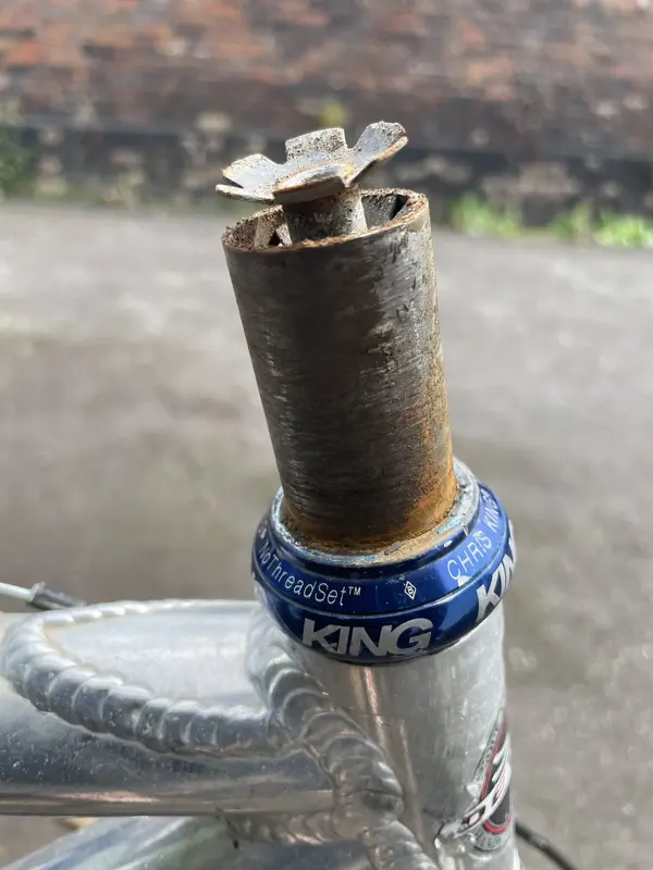

I also found the crown race has a bolt sheared inside so I could do with a new crown race and the steerer is potentially a bit short.
So. Pace RC36 (gen 2 are they?)
Rear brace
Crown race
11/8” steerer
Please 🙏

I don't have the parts you need but have had the same forks so can offer some advice.
Flipping the bosses the pace way round is simple, you just have to be gentle when making them fit over the dropouts. You might need to prise them open a bit to clear them, go steady or you may snap them.
You might be able to get the sheared bolt out using an easy out tool. I've done that myself on pace forks.
Brace wise, the one fitted has been drilled, for what, no idea. Also the boys fitted are all wrong. I'd check that they haven't been replaced by ones with larger threads.
Now I could be wrong, but I'm sure I upgraded a set of forks I had with the carbon braces. Don't take my word for it though. Here's some in case they do fit:
You could contact Tim, username just backdated as he runs fork English and services pace forks, he may be able to advise or even have the parts you need.
Good luck. At least there's a nice headset on there.
@ishaw
Thanks for the tips!
I have been sent the link to those bridges so I think I'll go for them. I couldn't find them myself because I was searching for a "brace" rather than a "bridge"
I did notice the one I have has been drilled too. In random spots as well so no idea what was going on there.
I'll do my best to get the snapped bolt out when I strip them down. I've got some extractor kits - just hope there's no corrosion around the snapped bolt welding it in!
