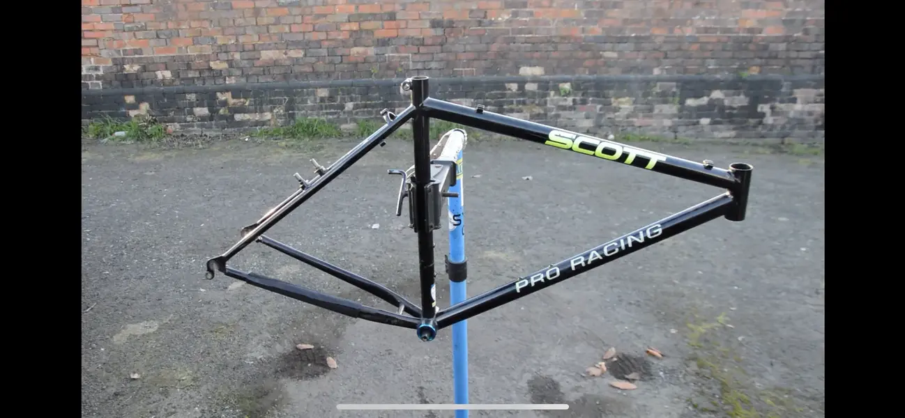

Thought I’d start this thread to get some input. I picked this frame up a couple of years ago from a member here. I thought I’d found a ‘Team’ a while before so when this ‘Pro’ came up I grabbed it.
Really nice Ritchey tubed frame. Awesome. It was a little beat up with a tonne of stone chips to the chainstays but it didn’t look too bad tbh!
Fast forward a couple of years and I’ve collected all the bits for a build. A complete XTR group, a spotless XTR seatpost, the original SRP fork, Ritchey WCS bars and pedals - it’s looking good. I decided to have the frame blasted and Cerakoted and grabbed some decals from Gil. I realise the decals aren’t the fluro original now though.

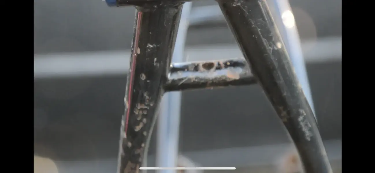

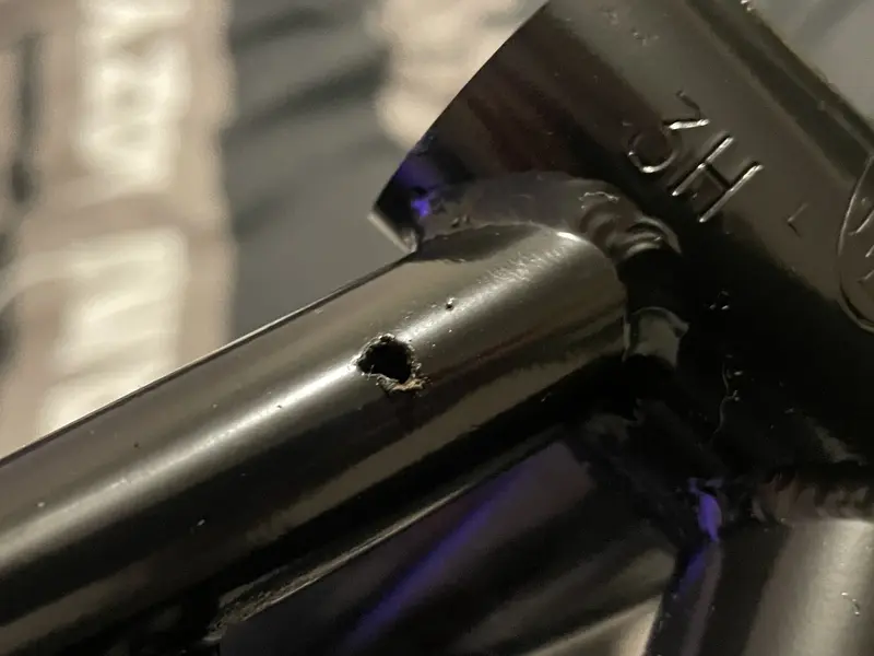

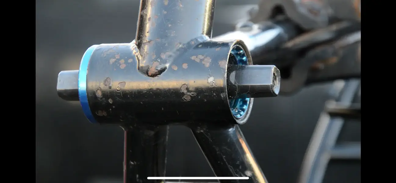

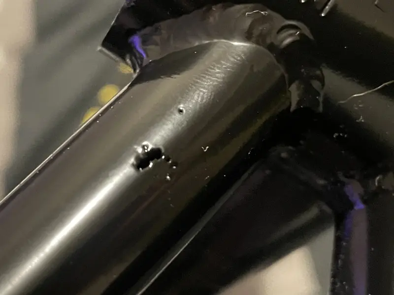

Anyway - last night I go to take a pic of the serial number and realise there is a hole in the chainstay. Poking that hole then made it bigger. There’s also a small pin hole in the other chainstay too. It’s something I never noticed until now.
Looking back at old video I can see what could be a hole but it blends in to the stone chips so well.
Considering this is going to be some lightweight tubing and the frame has clearly had water sitting in the chainstays for it to rust inside out… the frame is toast right? I’d wanted to build this to ride and possibly race it at the Cannock Classics but now - I’m wondering how much the rust has weakened it.

It might just be the chain stays that are toast, but you'd want to check the interior condition of the bottom of the seat tube and seat stays.
You can "show" it as is, but we all know how it is having something that looks good but there's something nasty out of sight😬
Replacing just the stays would ruin most of the new paint, and if it's in that sort of internal condition anywhere, it's probably not worth the full lay out - i think you need to look for a better one, chalk it up to experience😪

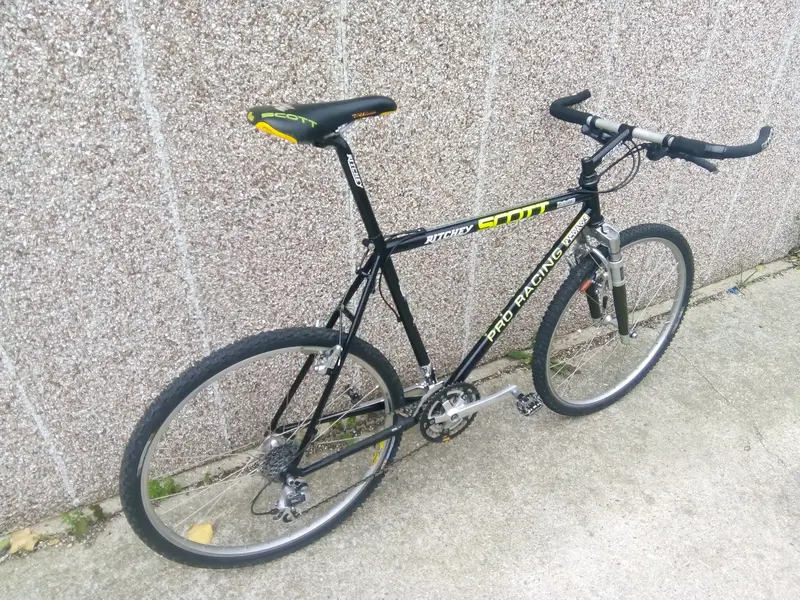

This is how a proper one should look. Won several retro category races on it. They are fantastic race bikes
